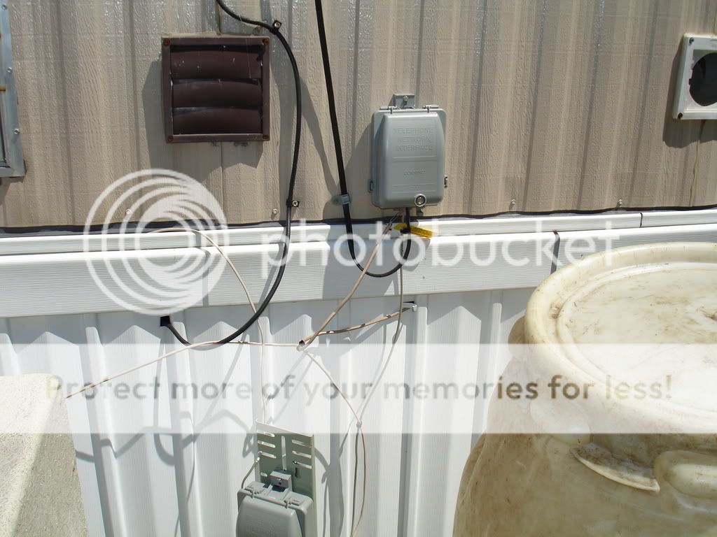

i keep getting in my neighbors phone, its cordless at 2.4 ghz, im running either my uniden washington or pc 122xl going into a klv 203, swinging up to 150 watts on am, 185 on ssb, upon talking to my neighbor and apologizing for wiping out her phone i was left wondering how am i interfering with a 2.4 ghz phone , antenna is antron 99 at 30 feet, swr with amp on is 1.1 to 1 across all 40 channels, coax is rg 8u at 100 ft from antenna to radio room, i went outside to look around and i found the problem, the phone interface for her trailer
how do i stay out of this spiderweb of phone line ???
The drop to the left is the cable, the one to the right is the phone. The phone interface box looks like it's already grounded. The yellow tag on the box is the ground tag. The other box hanging looks like a box not being used. You can take all the phone lines and go into one box. Strip back the wires. just hook up the red to one post and green to the other. If thier using cat5 it's blue with blue and white. Most likely it's not her phones. Go back home and groung the shit out of your stuff....

Your neighbor lives in a metal can, not much you can do about that or the situation you have with her phone, stop and think about it, it's a cordless phone and that means it's not connected physically to a phone line and is subject to any rf that happens to come in contact with the phone itself so it's up to you to get your system cleaned up and making sure that her trailer has a sufficient path to ground regardless if the phone interface is grounded or not.
Good luck but I don't see luck helping you any at all.
The handset may not be connected to a phone line but the base unit is and that is where 99.999% of the interferance problems occur.RFI direct to the handset is extremely rare.Try the choke on the antenna feedline to help prevent feedline radiation and also look at ferrite on the telephone line going into her house.Since the telephone line is unshielded,grounding the entrance block will have little or no effect.It is for lightning protection and has a spark gap built into it to protect the line and equipment from high voltage but not RFI.
