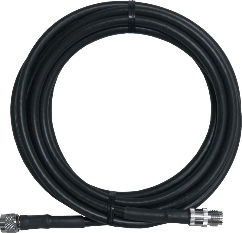

I am using the K400C Diamond Mount
The mini coax is 6.5 inches long to get inside the trunk without "pinching" the coax.
The mini coax has a mini UHF connector so you can connect the Diamond extension coax which has the other end of the mini UHF connector and route it to the radio.
Unfortunately that extension is 10 foot long.
I only need 3 foot I am guessing so the trunk can open and close. I know better than to "coil" the coax. I do not want to run it back and forth in the trunk because I use the trunk quite often.
What to do?????
No reason why you can't coil it, but I'd just cut that extension to whatever length I need and solder a new connector on.
Why not coil it? It won't affect anything nor will it choke off RF except for what is on the shield and that is a good thing. Not coiling coax because it will affect things is an old CB wive's tail.
