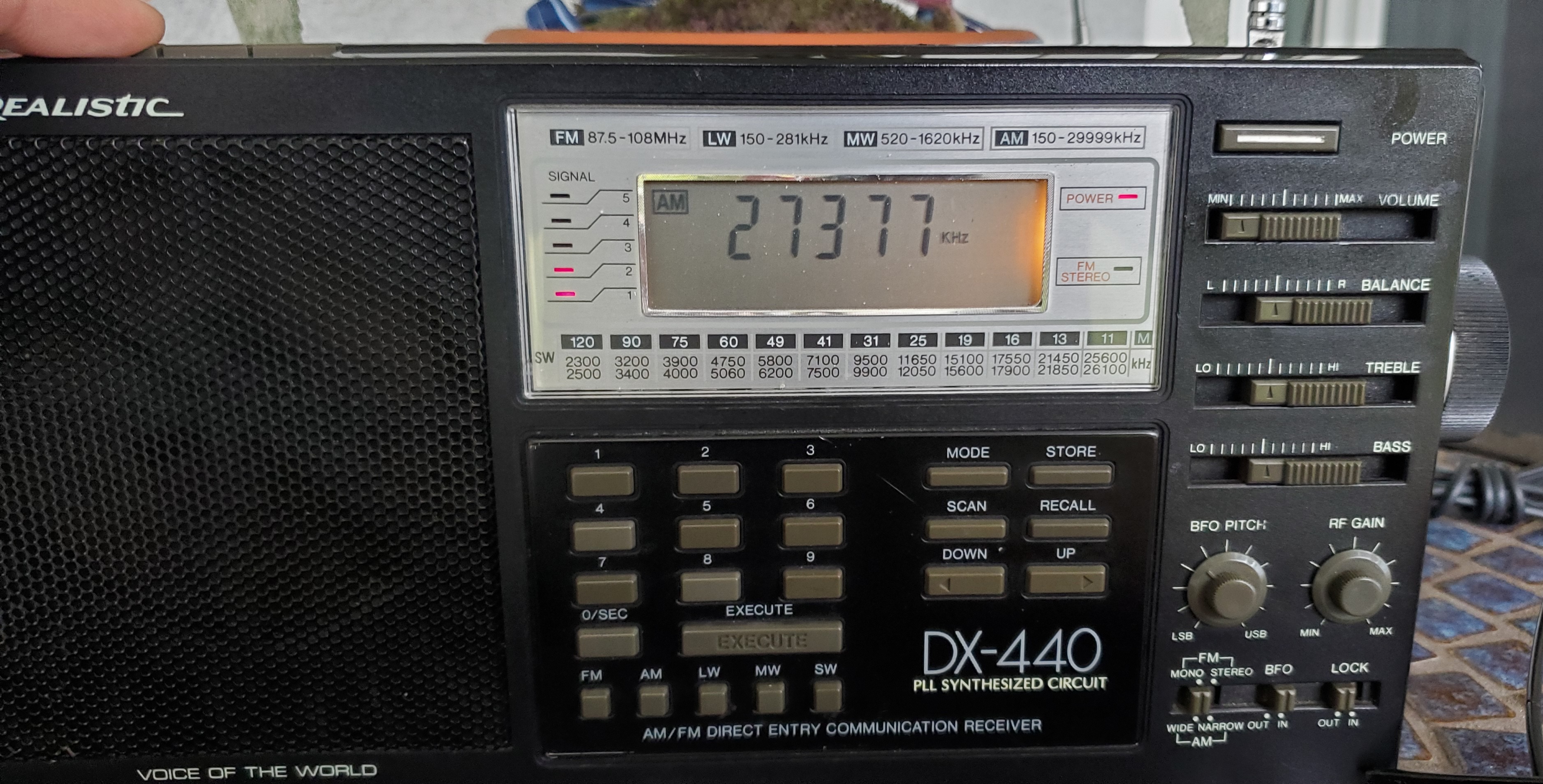

Not sure if I'm posting to the correct forum. My issue I need help with. I have a in great condition Realistic DX440 shortwave receiver. It's off frequency by about 2Khz. Example 1070 Khz AM on the display, but 1072 Khz AM sounds tuned in the best. I wanted to know what the location on the pcb board to tune this radio back on frequency so that is tunes to exactly to what the LCD readout out reads. To tune into channel 37 LSB I have to go up 2 Khz to 27.377 Thanks for any suggestions.
