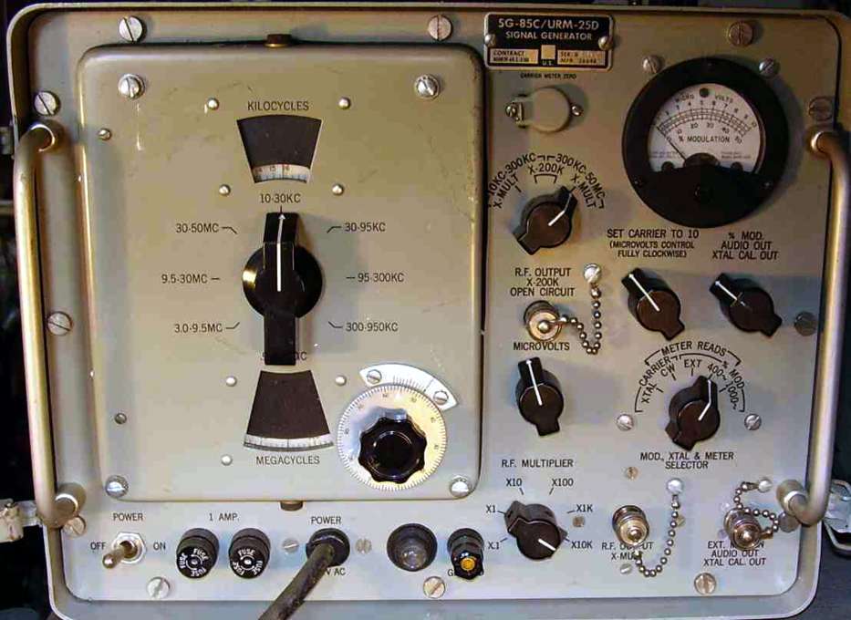

Many years ago I lucked into an RF signal generator at a ham flea market. I paid $15 for something made quite likely before I was born or perhaps about the same time. I am currently 53 LOL. It is an AN/URM-25D Signal Generator made for the military. It has all the attenuators and cables stored in the cover. It is not light but it is very good. I got it home and opened it up to take a peak inside and it looked like new inside. The silver switch contacts were still bright and it even had that new smell. It was used however as there were a few scratches on it but nothing significant. I checked the accuracy of both the freq and the output level and it was bang on. Once in a while I fall into something and come out smelling better than when I went in. LOL
https://en.wikipedia.org/wiki/AN/URM-25D_Signal_Generator
Reactions: LeapFrog
Mil-Spec that's got awesome written all over it, seen some on that popular auction site. The ones tested are selling for a lot more than the as-is units. This is one purchase I wouldn't regret, even if it didn't work!
