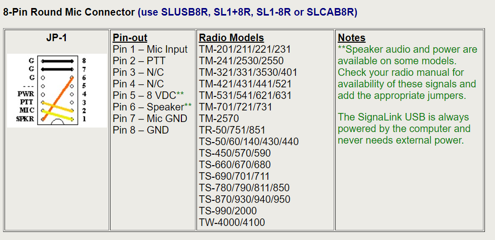

I am looking for a connection diagram for a Kenwood TS-930S and a Tigertronics Signalink. I have not found any information as to how to do this or if it can work? I have seen interface cables but nothing that says it works with the TS-930. thanks in advance for any help.

Found this link.
Signalink wiring for Kenwood Mobile/Base
As long as you got the cable, it should work for yours 930S. Wire the signalink as it shows on the website.
I do see it listed as the 930, but basically the same radio.
