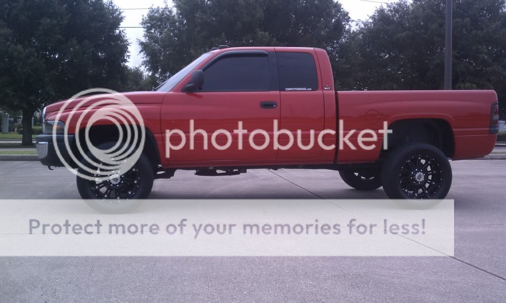

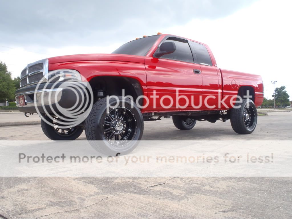

And it goes on a 2500 and not a car if that matters for any reason.

Why the spare tires on a big 'ol truck. I got 33s on a Yoder. :)

It had 35s and went to those tires and wheels because that truck was supposed to by my drag racing truck, but my plans changed and am having to delay that goal for a few more years. It was supposed to be lowered back to factory height in the front and 2" in the rear then was supposed to get another turbo hanging under the current 64mm... ;)

Factory front springs and I was supposed to lower the rear to match.... but as I said, didnt happen so I put it back the way it was.
