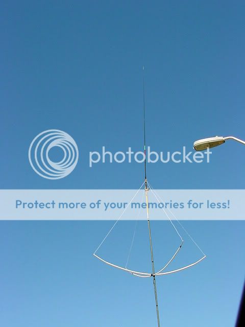

I make a Starduster type vertical using a mobile mirror L-bracket and a hub from an A99 GPK attached to a suitable mount and if I make it with two hubs I can use 3,4,5,6,or 7 ss 102" whips and it works well. This is expensive also due to the cost of the whips. Image here:

I find this antenna very effective, with a nice wide bandwidth, that works well, and is very quiet if conditions permit. I often can copy signals on this antenna that I can't copy with some of my other vertical antennas. It is very durable and light.
Awesome little homebrew, too!
Homer, the wires look a bit short, are the supports part of the radials too? I may have asked already, but how did your antenna respond with BW, signal, hearing, and noise?
The antenna was made for use on a friends 40 channel CB, and when I had it up it had a SWR of <1.3:1 from 1 to 40.
As for performance, it rocked. It outperformed the A99 that was up in the same spot and height immediately before it. The receive was really good, too. We did not do any testing, but did note that it did really well.
The appearance of the radials wires being too short it due to the disproportionate length of the vertical. There is a wire running upward through a fiberglass fishing pole making up the vertical. The pole is 13' long, so the wire is about 4' shorter. Use your imagination to shorten the vertical and it will be better.
Also, the yellow part of the mast is a fiberglass post hole digger handle, and is about 4' long.
Homer, I was thinking maybe the top was aluminum tubing. I Ctrl+x in on the image a little, but can't tell if that's a choke or part of the FG handle. How did you feed it? Do you remember the dimensions in case BamBam wanted to try it? Is it holding up at your buddies?
BamBam, if you use tubing and depending on the diameter used...you may end up way too long at 108" for the length to start. I think the M400 is made up of .625"/.50" material and the hub is maybe 2" x 3" long as well.

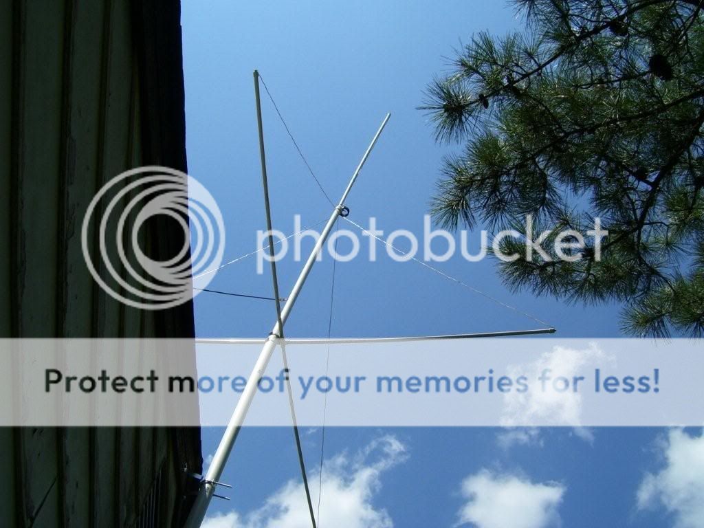

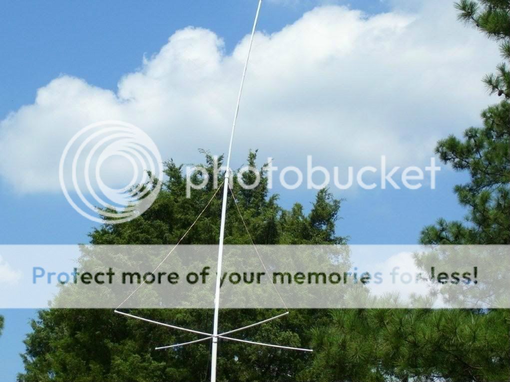

heres my 12 gauge speaker wire starduster/.25wgp result .
it had some lean to it . LOL
i made the four ground elements 108 inches . i started the vertical at about 112 inches and clipped it down a inch at a time till i got to 1.3 on the vswr . i didn't measure its length after tuning though . i could have got a little lower , but i was tired and didnt feel going lower would make any difference to my tx/rx or make the radio/amp any happier .
the grounds are at a 33.7 degree angle according to this site . the X standoff is just four 5 ft. pieces of 1 inch PVC with a 4-way in the middle . it was taped to the side of the mast .

i did put a air coax choke at the feedpoint . but i know now it was the wrong size and wrap count .
thats pretty interesting BB that your 1/4 home-brew beat the antron . the antron had a 9 ft higher tip height and the lower TOA of a 1/2 wave .
but antennas are just full of suprises ;) .
