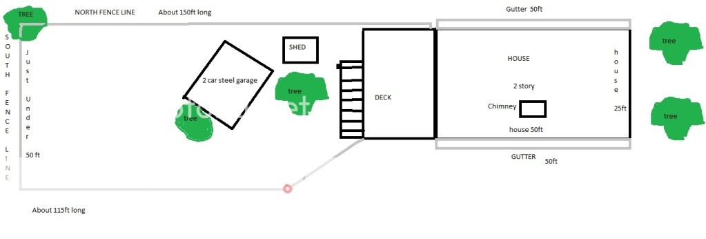

so maybe this would work?

I was thinking about using my fence as a counterpoise and at the feedpoint attaching an element cut for 160m, 80m, 40, and possible 20m I figure I could fan them out and tie them to trees

Right now I am running the south rain gutter (in addition to the down spout) connected to the coax center conductor and then I attached the shield to some 18 gauge balling wire that connects to the top post of the south fence line at the area marked in red

maybe a 1/4 wave fanned inverted L (160/80/40) I still think I could use the top fence rail as a counterpoise, instead of just connecting the shield directly to a ground rod
well the way I have everything hooked up is simple...
Yeasu FT890(HF RIG) > 3ft RG8 MINI > MFJ 962c(TUNER) > RG8 MINI 24 ft > antenna
the antenna is as follows center conductor of the coax runs to a point that has 3 elements one is a little over 140ft, then around 75ft and around 40 ft
@ 1.8Mhz the SWR is a little less than 3:1, however it is closer to 1.2:1 @ 1.6Mhz... and @ 2.0Mhz it is a solid 5:1 or more
the tuner does nearly nothing for this, in fact I think it's a 'better' situation with out the tuner
the story is nearly the same on 80m and 40m too...
however the higher up in the bands you get the better the match becomes
this is leading me to think that the top rail of the chain link fence is not making for a very good counterpoise...
well I am open to ideas.
