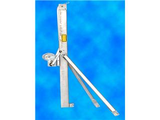

not my tower buy was going to build a fixture like this to raise and lower the new tower.Looking at the Maco M105C and mounting Horizontal But wonder what other Horiz. 5 elements are available.
