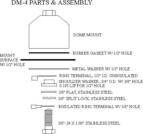

I've been looking around, and believe it or not Firestik has one mount that looks pretty tough for a cheapie. It's nothing like that M8 custom piece, however (bear with me here)
I looks like the the tipical dome mount but its not. Inside the plastic dome is a solid straight through stainless piece machined from 9/16 stock. It feeds through the mount plate with a 3/8-24 stainless steel bolt, and has lug terminal ends. The one with the so-239 connection looks weak though. Here's a pic. What do you think ? Looks to me like it fairly strong and no way it could short out ?
http://www.firestik.com/images/dm-4.jpg
http://www.firestik.com/Instl-Art/te-dm4.gif
