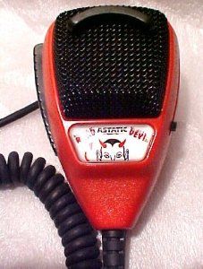

Is that what this microphone is manufactured for? Is that Half Moon piece of plastic at the top of it there so one could make out with their mic? I never use hand Microphones at the base because my disability makes it difficult and uncomfortable to say the least.. I guess figured out I also don't use a mobile as it's impossible to drive with hand controls and key a microphone at the same time. On my current setups I used two d104 microphones. I do have several Turner + 2 and 3 microphones but for some reason I don't get get good report with them. Even though I've read and heard several of the Turner's especially on SSB and for others they sound very good. I think it might have something to do with my voice characteristics. They just don't match up well with the Turner microphones. Loose Cannon recently performed one of those fet modifications on the one of my silver eagles. I use it with the Madison and I must say it works very well according to feedback that I've gotten. I normally use the Madison on ssb only as I enjoy using the 2340 as my AM station but that fet mod according to locals sounds so nice I've occasionally been using the Madison on AM.

Exactly. That is a lip bar that is held gently against the upper lip in order to provide PROPER distance from the microphone. Since it is an amplified mic you do not want to have it very far away from your lips because it will pick up extra background noise if turned up very far. I have ALWAYS close-talked with all my microphones and tend to talk rather clearly and slightly louder than normal conversation. This ensures the best signal/noise ratio going into the mic and minimizes background noise pick-up. The mic case usually just touches my upper lip but I talk across the element and not straight into it. This also avoids those nasty pops and such from certain consonant sounds. I do not get poor audio reports nor have I in nearly 40 years of radio.

I also believe correct use of a fist mic is to "close talk it" holding it sideways talking across the element not into it. And I tend to do the same with my D104 and other desk mics.Sit them on my desk turned side on ,so I'm only about 1 to 2 inches away.
having used road devil mics for 30 or so years has taught me to do that too. my echomax is set with higher amplification than most could use because the sensitivity is set so low. that way I can lick the crumbs off the windscreen while I talk.

If you like the fet conversion on the D104 you should try the fet conversion on one of these for the mobile...
