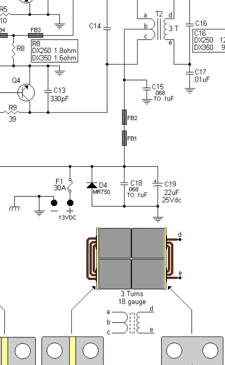

Hello, I have a texas star dx 350 that has worked great for years. i noticed when i went to turn it on, it was super hot and drained my battery in my truck. the amp turns on and preamp works. I did a visual inspection and can't see any burnt/damaged components. Why is my amp getting very hot when off?? Any help would be greatly appreciated. Thanks
Definitely shorted somewhere.
Just so you know, the on/off switch does not remove power to the amplifier.
The on/off switch removes power from the relay and preamp function.

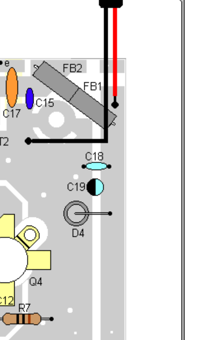

A shorted D4, or C18, or C19 could cause this.
Or a couple of other components.

This will help find the area Ranch 55 pointed to in his post above.

D4 is what I was suspecting. Anybody know what kind of diode is D4?? Ive never seen that kind of diode before.
