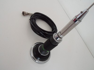

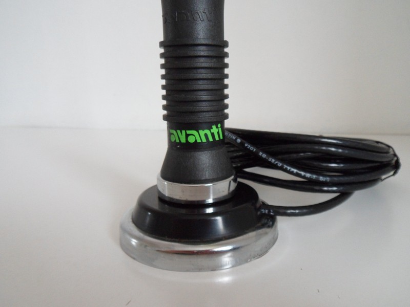

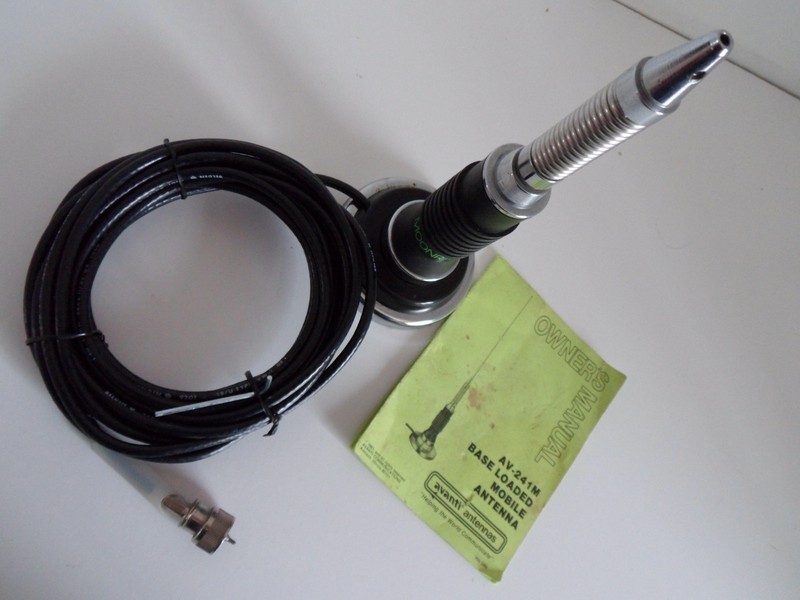

You should buy this before it's gone.
http://m.ebay.it/itm/AVANTI-AV-241M-MOONRAKER-MOBILE-ANTENNA-RADIO-TRADER-IRELAND-/322490477443
