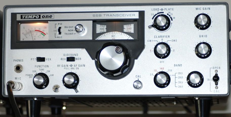

FT-200 hey? They were also known as the Tempo One.Does it look like this?
They were a half decent radio but the modulator tube was prone to microphonics. Not sure if there was a replacement for the problematic 7360 beam-deflection tube used as the balanced modulator or not.
Later Tempo Ones (FT-200) used a little plug-in board in place of the balanced modulator tOOb. These tubes are expensive now. Maybe they were then also.
That rig sucks on AM. It doesn't really make AM. It transmits one sideband and a re-inserted carrier. AM receive is through the filter which is an ssb filter. Not good.
If one removes and bypasses the crystal filter and disables the ALC the Tempo One makes an excellent 25 watt AM transmitter. Those mods will render the receiver too wide for use. A 9 mhz 6khz wide filter can be diode switched and retrofitted.
Nothing at all wrong with sweep tubes if they are used in a proper design. In the Tempo they will last a long time if not abused.
