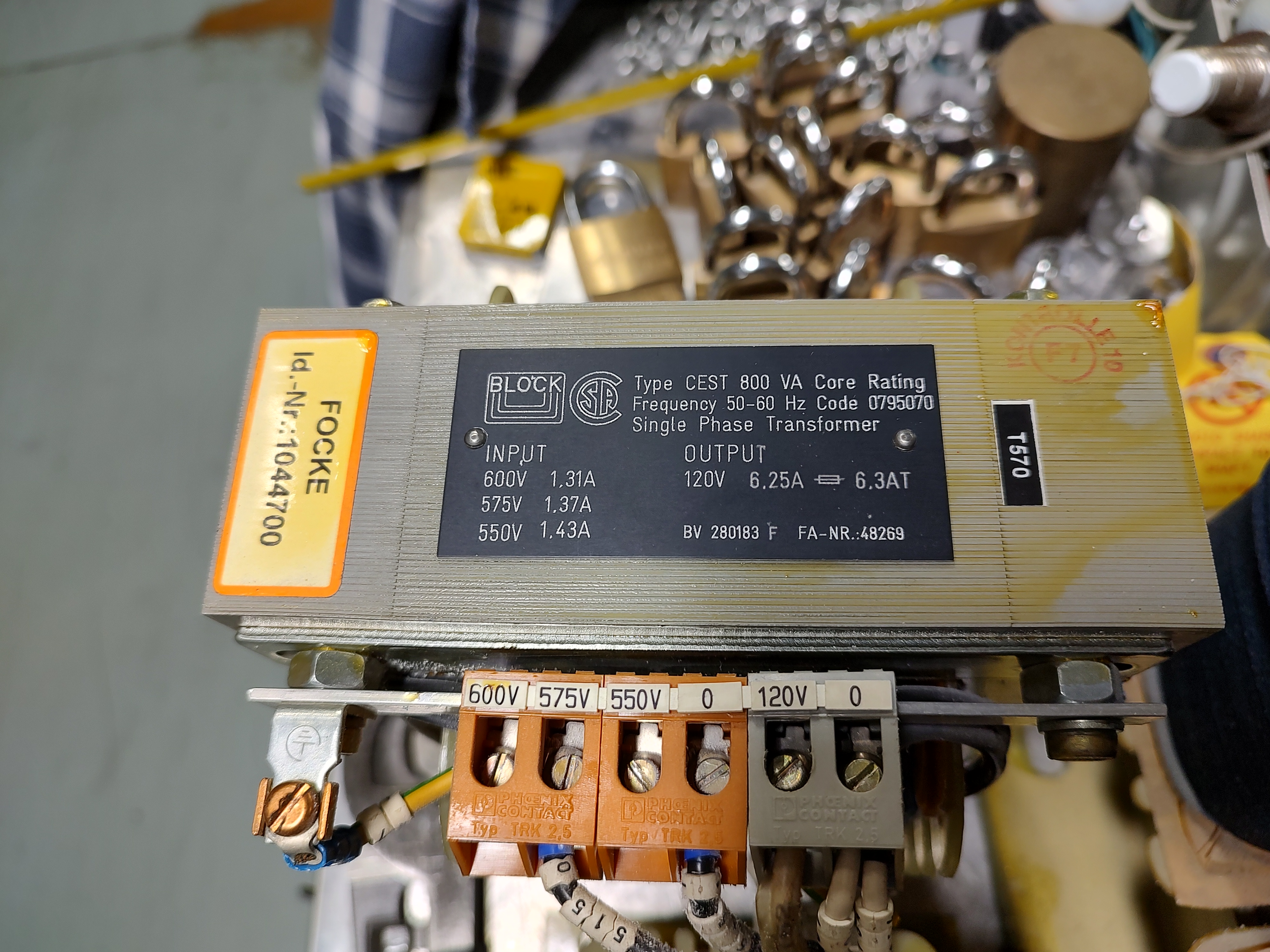

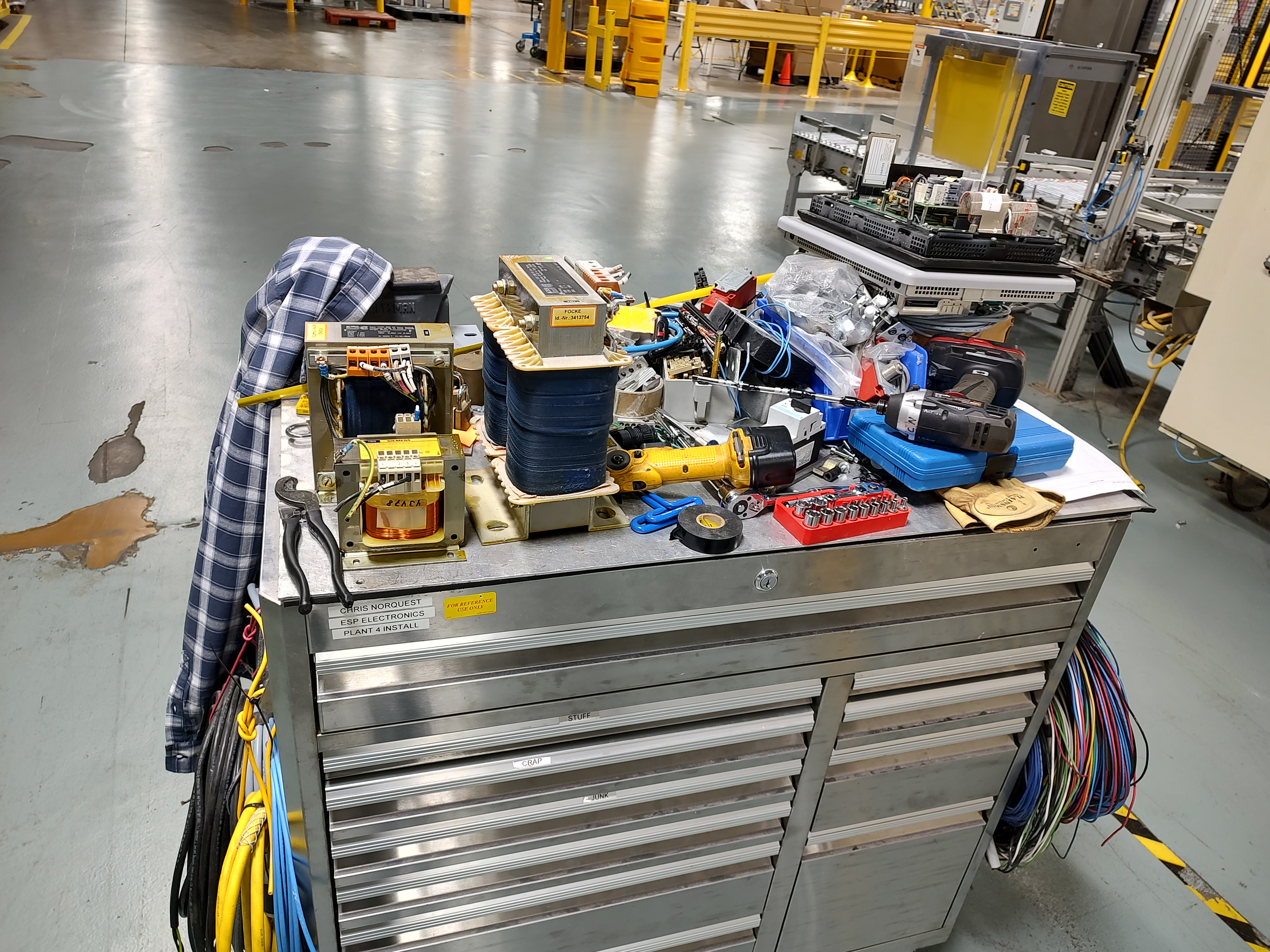

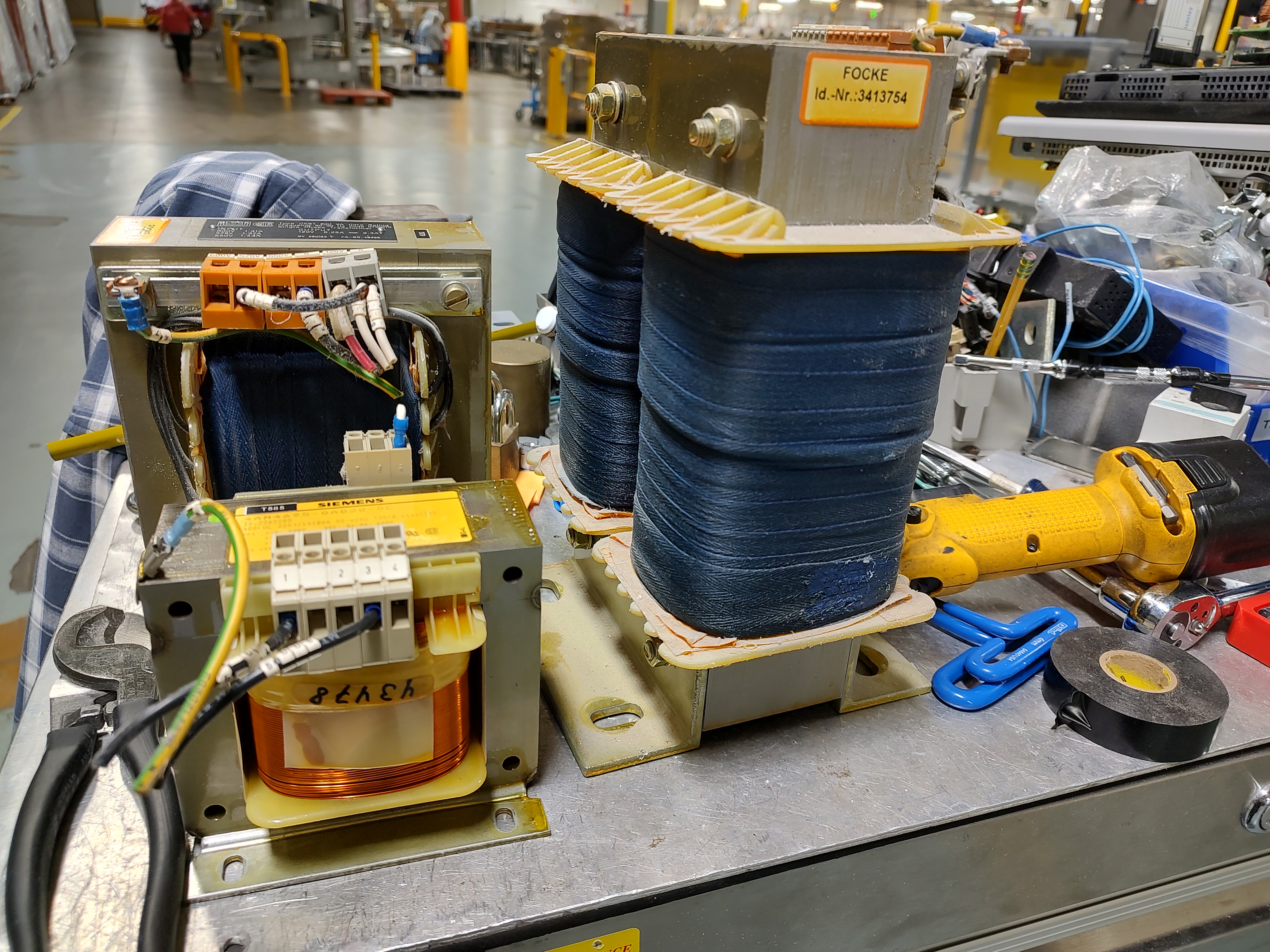

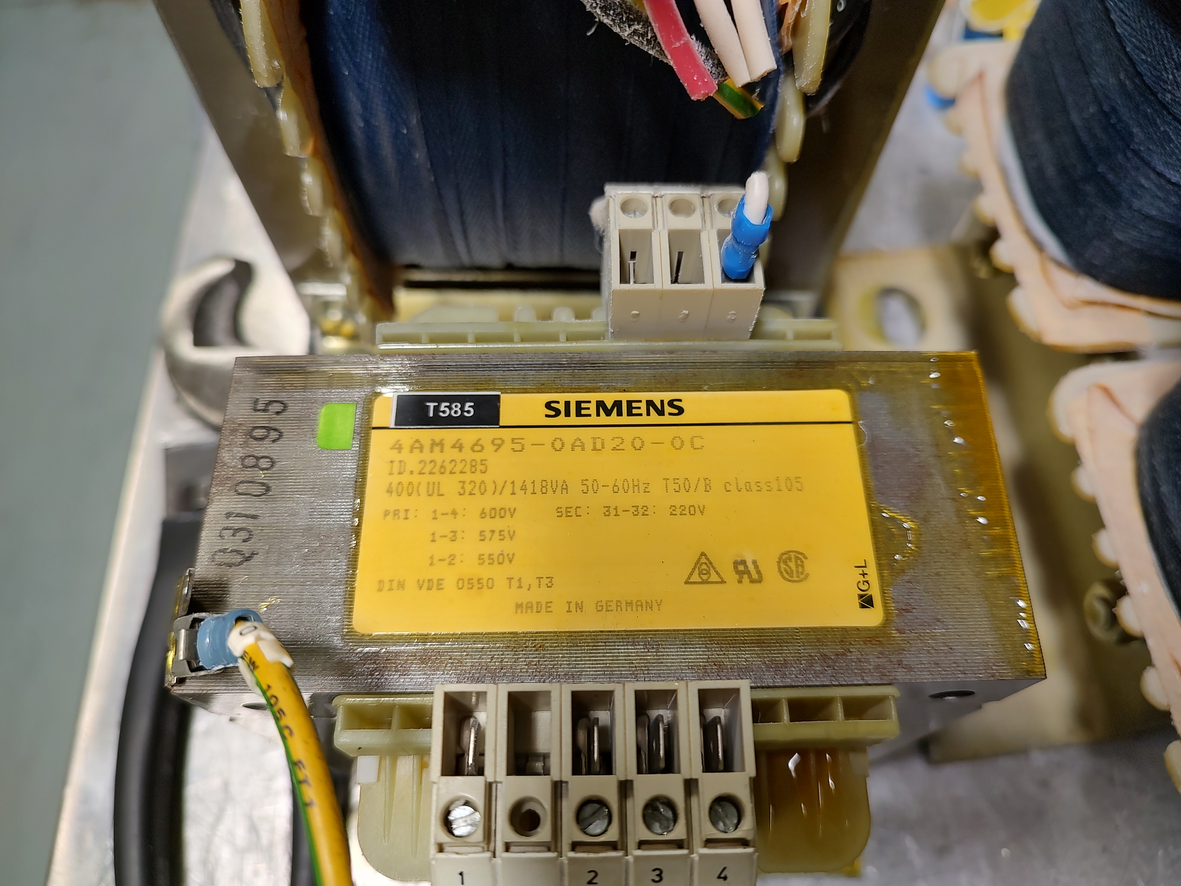

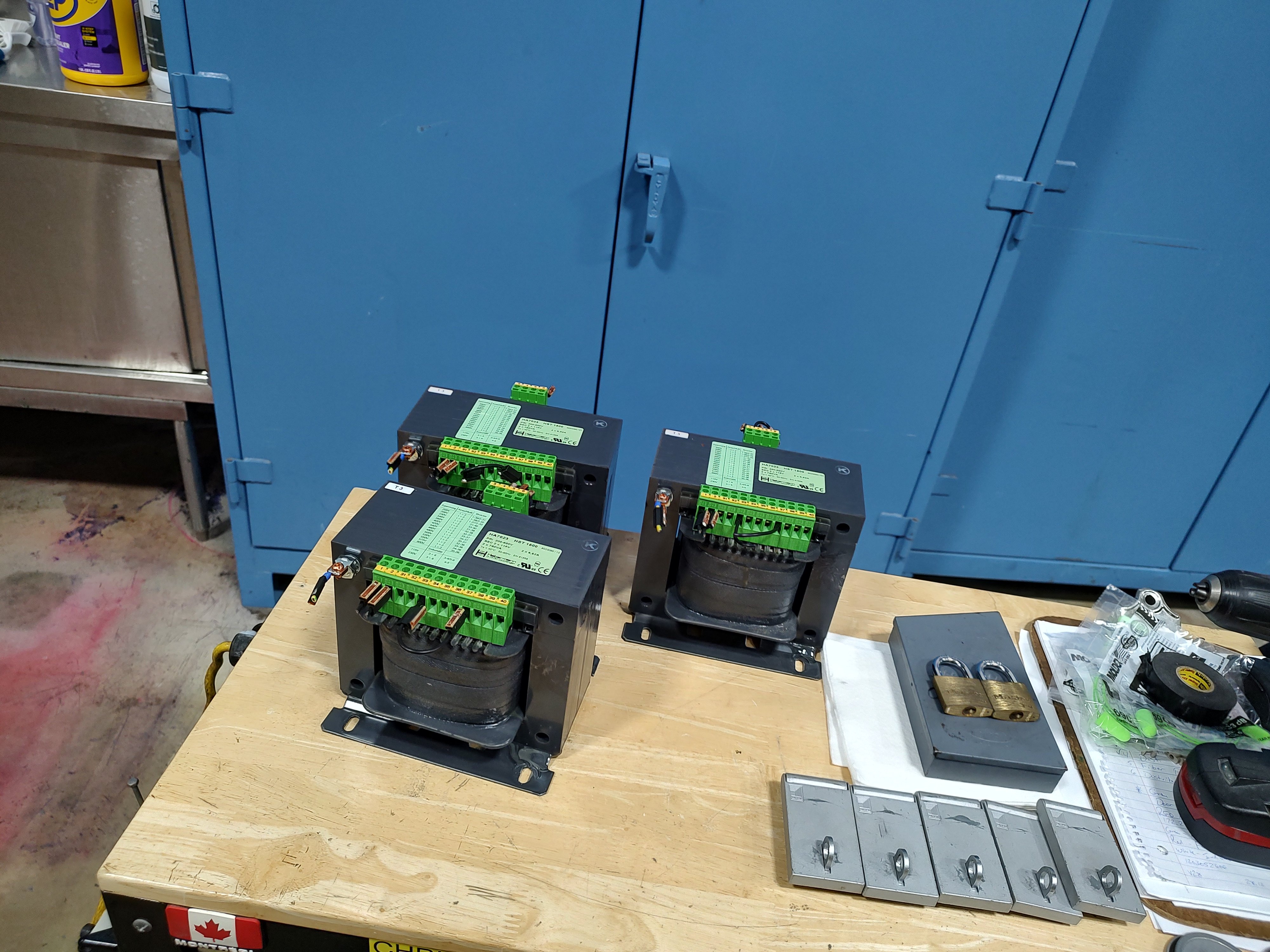

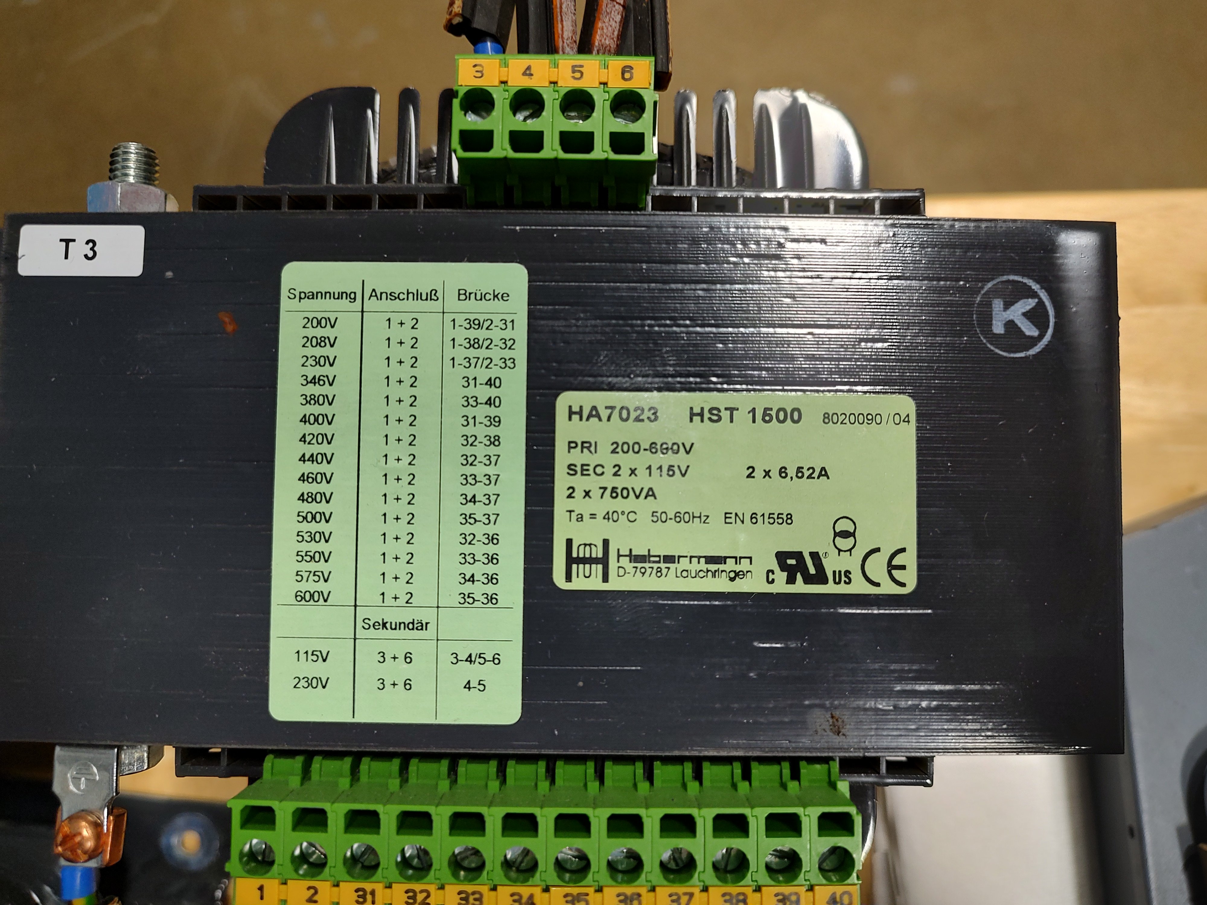

We are dismantling an old production line at work, and one of the pieces of equipment had these neat transformers. They are step down to provide power to control circuits and motor power. They have a 600v primary and I was wondering if I could power the secondary with line voltage to use as a step up transformer? Even the little one is heavier than it looks.
