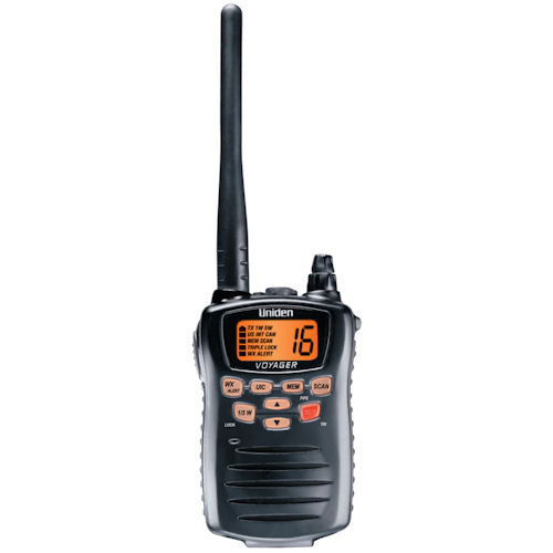

I would suggest getting a "Uniden Voyager" marine VHF. I have one and it is a small radio (3.8 (H) x 2.4 (W) x 1.3 (D) inch). It covers US, Canada and International marine VHF frequencies. The radio comes with a DC charger and a desktop charger. I really like this radio because of it's small size and great battery life. I have used it for years and would recommend it to anyone. Here is the link: Uniden | A World Without Wires - VOYAGER. Hope this helps.
73 Darryl VA7DTP
