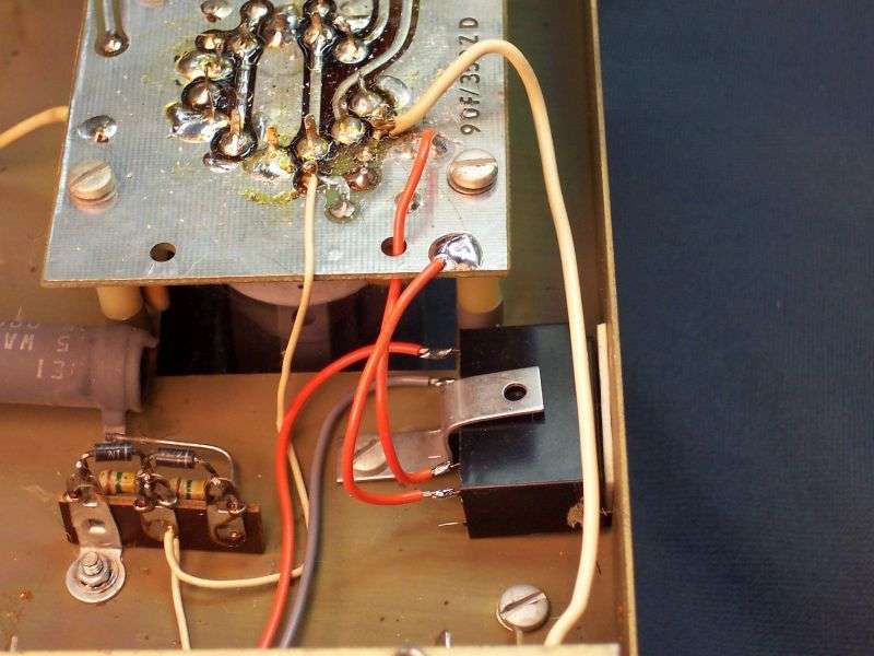

Years ago we did an extensive "rehab" for this model. It included an additional relay to shut off the tubes until you key it. This pic is from a different Palomar model, the 90A. It has this same problem, and gets the same fix.
Relays that will fit the hole pattern in the circuit board are extinct, and adapting it to use new relays that you can buy is a labor-intensive proposition. The High/Low drive-select switch on the rear is a nightmare when it goes bad, and the "overdrive detect" circuit is a part of that problem. The rehab process was extensive and expensive. And even after all that work and expense, the 350Z never delivers the same power as the older 300A model. Never have figured out why.
