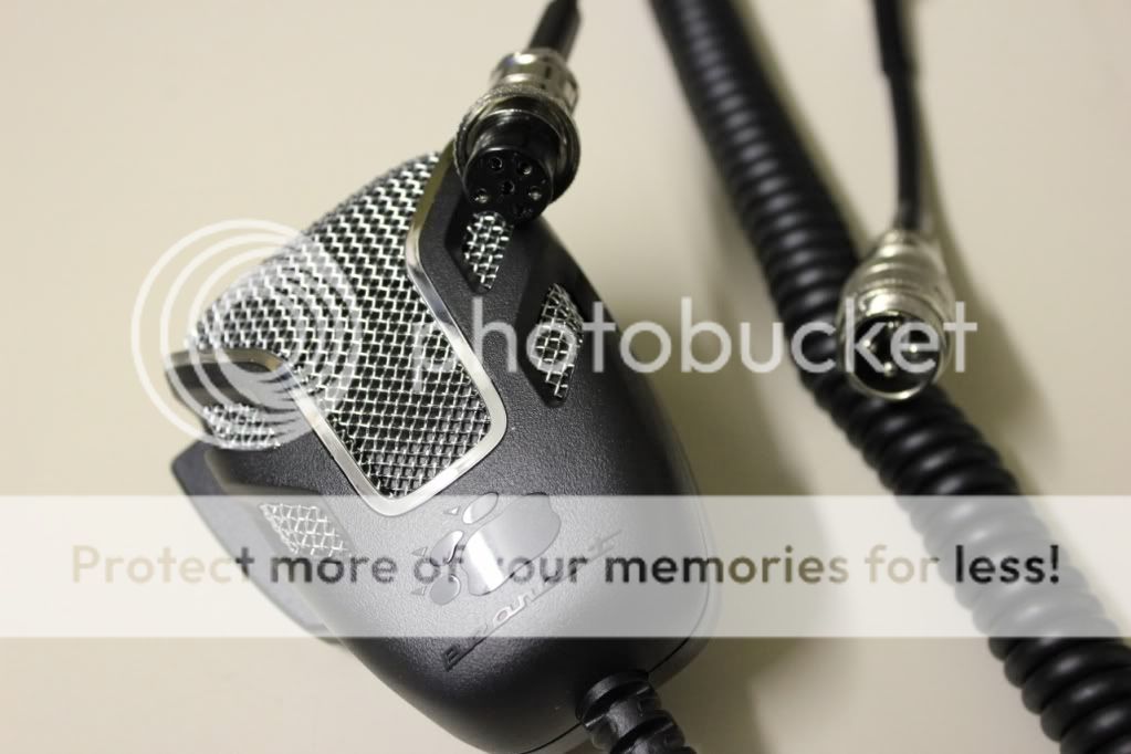

Radio arrived today - nice styling, fairly compact size, newer styling on the microphone (6 pin). Comes with a 6 pin to 4 pin adapter if you want to use a 4 pin microphone with this radio.

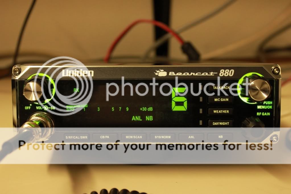

Features are cool, memory, scan, memory scan, SWR/CAL, ANL/NB, variable talkback, variable microphone gain (4 levels), weather channels (7) w scan option and weather alert.

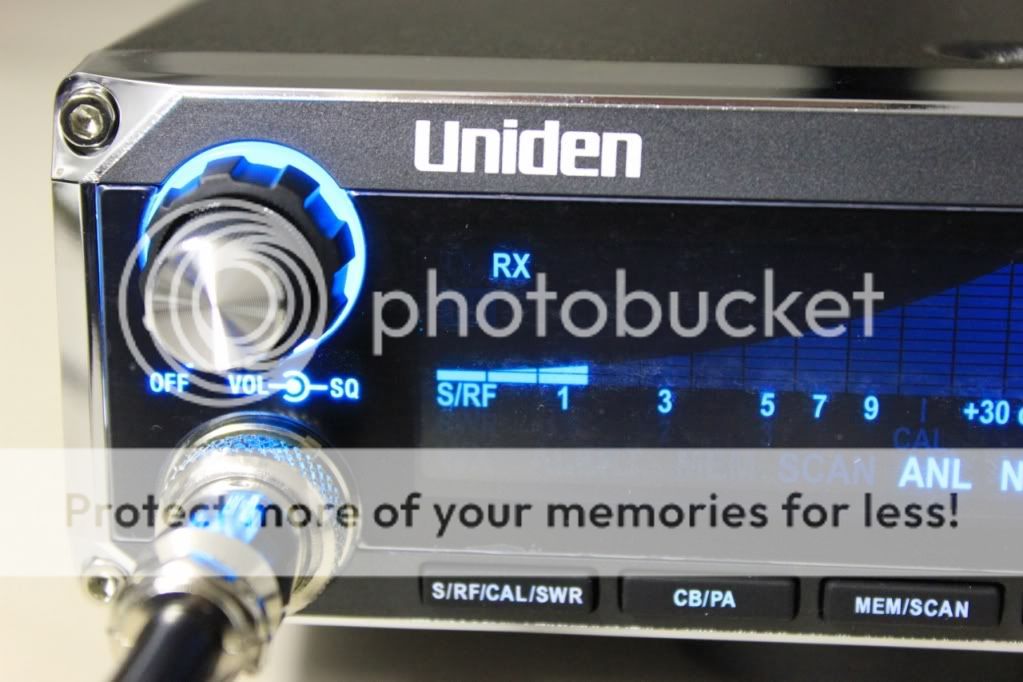

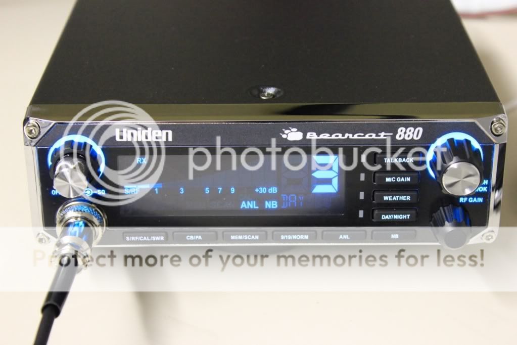

Change colors (7 options) you can change the colors for the day and night and can adjust brightness/contrast for both settings so you can have a red radio display at night, blue during the day, or green/blue, dim/bright, bright/bright, etc.
Also has the diagnostic features like Cobra LX LE, volt (gives reading), RF (pass/fail), Ant (pass/fail).

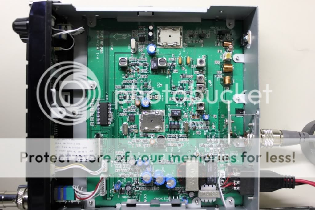

SMT inside, no pot for modulation as far as I can tell. So most people will probably add a power mike for more audio.
Nice radio for beginners, people looking for the newer styling. Mid-level and up will probably skip it because it isn't easily modded.

In my original post I was explaining that because it's SMT most of the people that liked being able to mod the Uniden 68/78's etc probably won't be wanting one of these. No variable pots inside except for meter adj's, sq, wx adj's.

What are the legions of "golden screwdriver trained techs" out there going to do now? No more clipping, snipping or running VR (whatever) wide open.
They're gonna have to learn how to write code and program so they can change the tables in the software. :LOL:
