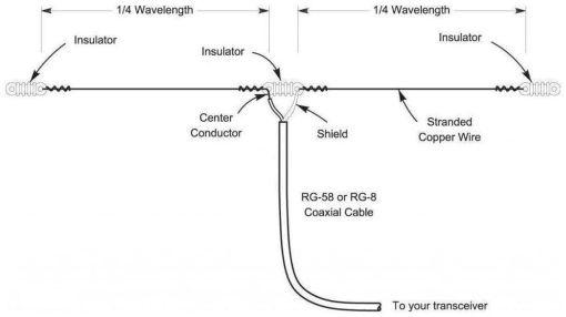

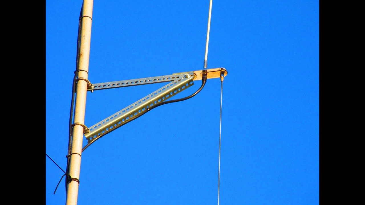

Thanks for the pics Jeff. I never made a dipole or seen one made so I don't understand how they are wired. Looking at the top pic is the shield of the coax wired to one of the stingers and the center wire wired to the other ? It looks like something I would play with in my spare ( HA HA ) time. Where is a good place to buy that top bracket or something like it?
