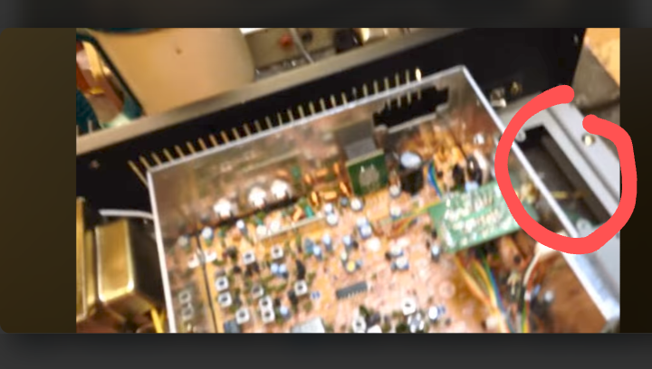

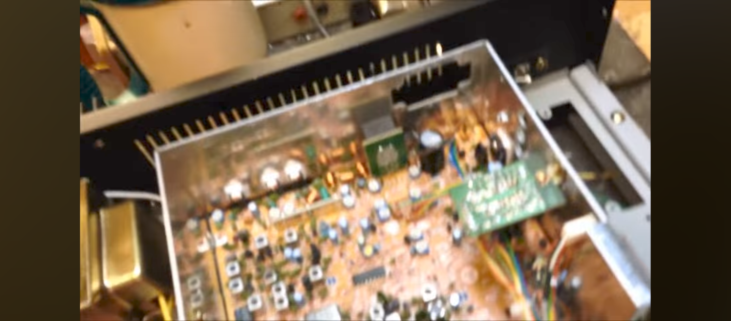

You mean the rectangular hole along the side just above the antenna socket?
That one is for a relay that provides an antenna A/B switch. Don't see it on models sold in the USA, but I stumbled across an older one that had the antenna select board. And a bum relay.
Not in the tall mobile like aluminum, but beside it to the right in the steel panel. I saw a video where someone had one mounted there. I don't know what radio and if it was factory or not.

That cut out in the rear right hand corner of the chassis looks just like the cut out in the derelict RCI2970 I have. It had a 6 pin Molex connector in it for the power cable. I removed that connector due to the pins not making good contact between the cable connector and chassis connector. I replaced it with a heavier connector used for RC aircraft. Works much better now.

I think I have seen the same youtube vid, not the power connector hole it's the one to the side of the mobile chassis.
