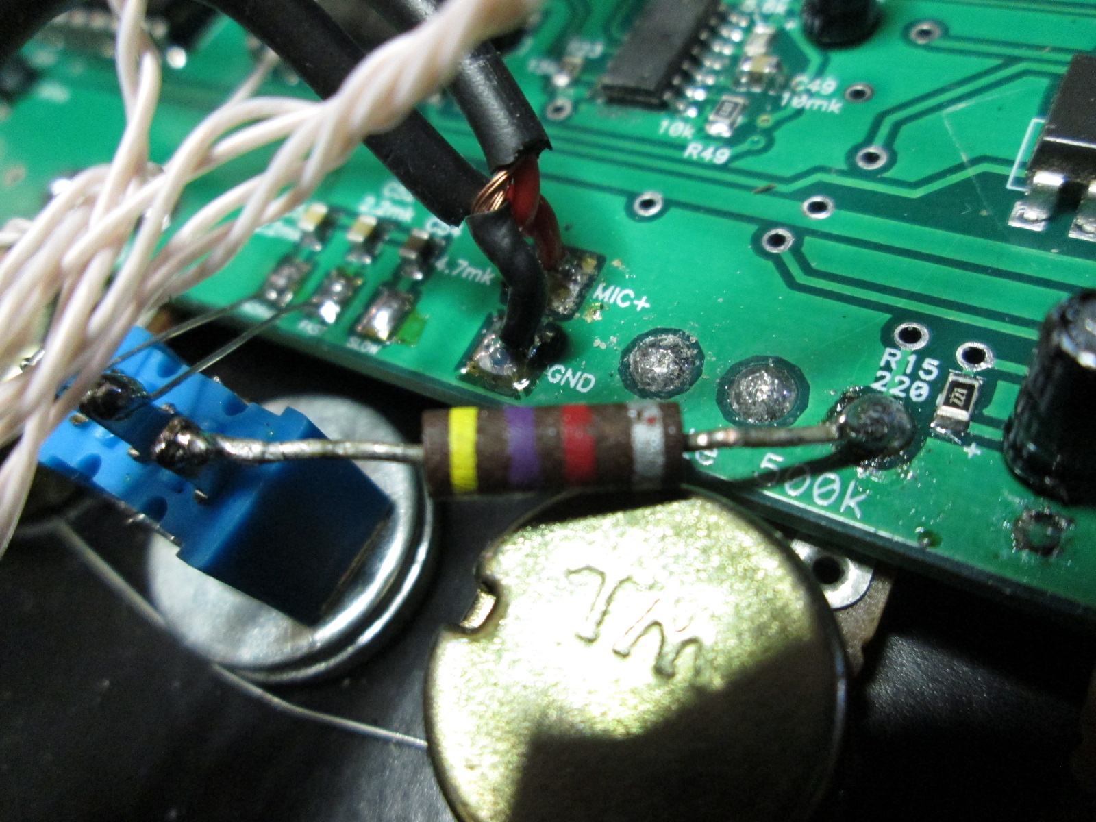

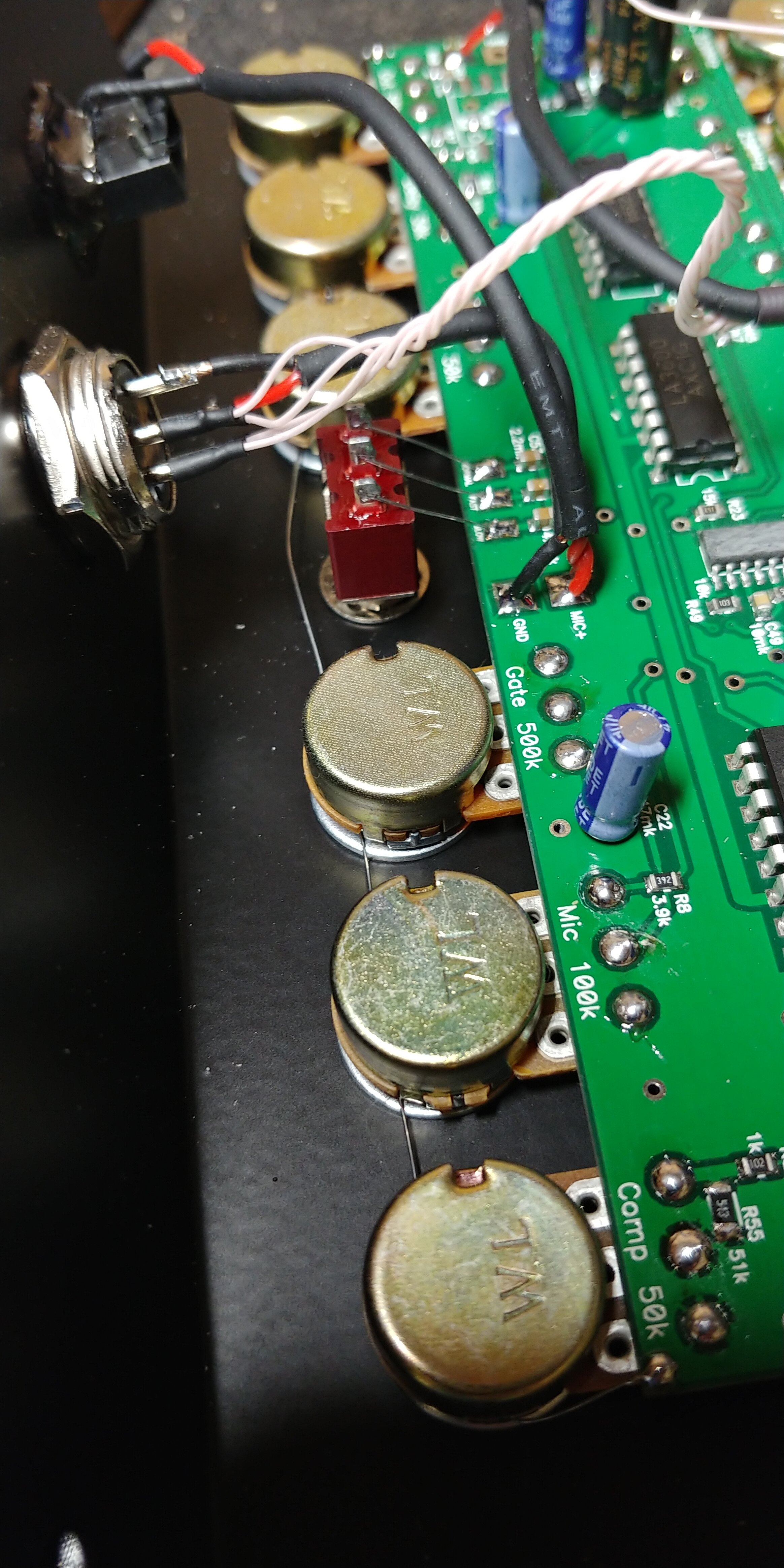

I did a mod to shut the noise gate off, I'm not sure if it will fry the noise gate (mod didn't work) but since
UR6QW doesn't communicate worth shit, I have to try and figure it out myself.
I guess the only thing I can do is use a 4.7K on the low side of the pot to ground and pull it to ground.
This disables the noise-gate altogether though. I tried all the way up to 1M and it wont pull it high when I try to turn the gate up.
With the gate all the way down it rumbles the audio from quiet to things like the clock clicking or me breathing, it wont just shut off and give you pin-drop audio, its always trying to kick in.
Its just annoying

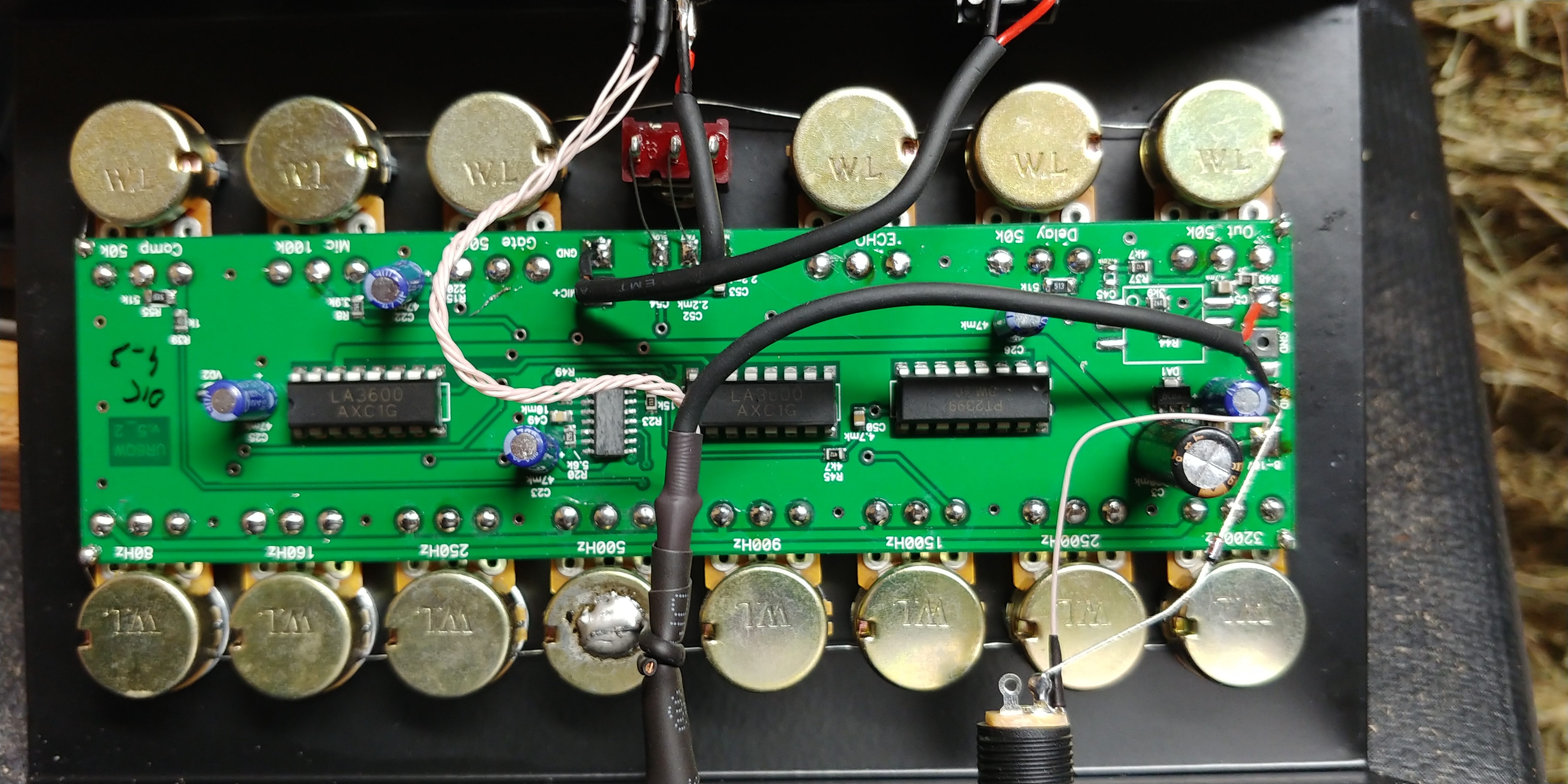

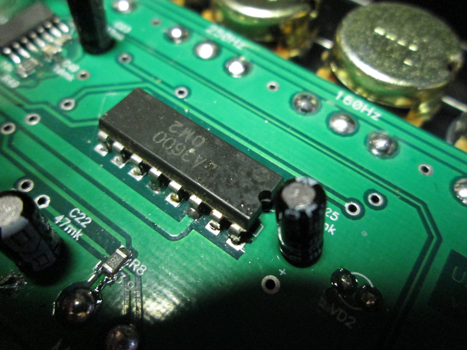

There is a chip thats scratched up to hide the name: SSM2166
Not sure whats up with that
OK I ended up removing the "slow" position on the time switch and running a 4.7k to the low side of the gate control.
So its factory set on fast and normal but on slow its "OFF".
As off as I can get it.
Just an update.
So far there's no way to disable noise gate except to unsolder the pot, which is less an ideal and theres something else that cracks in the audio on background and low peaks thats pretty annoying, just like the 858 chassis had strangely enough.
Its not bad but I'd would get the non gate unless you got a ton of noise to drown out.
I'd be nice to be able to disable it when not in use but its still there no matter how low you turn it down.

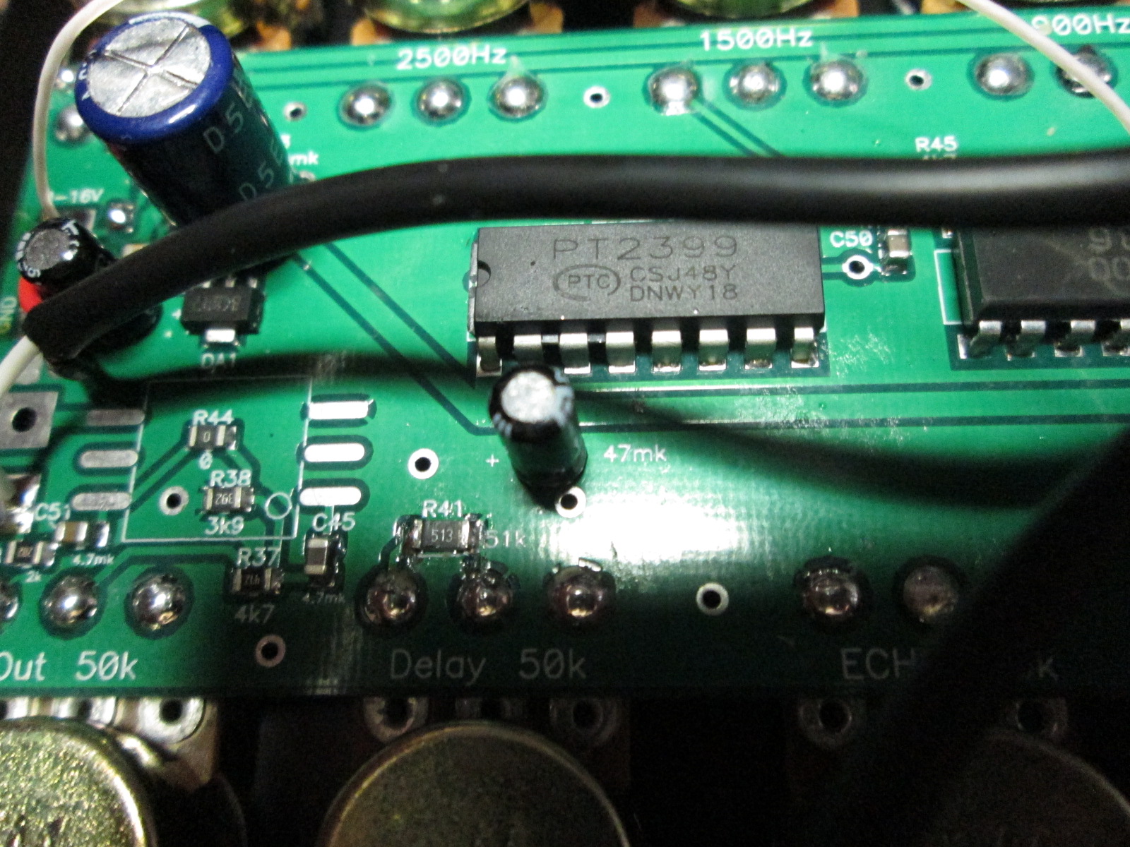

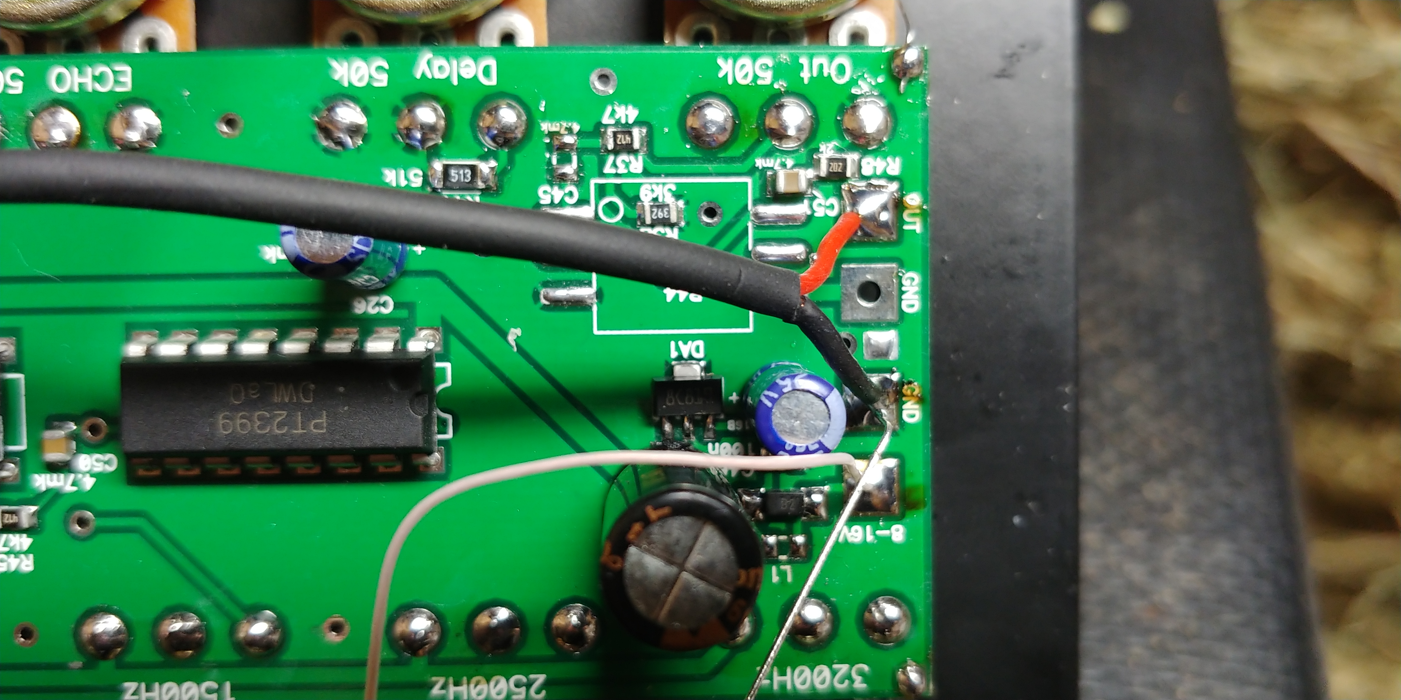

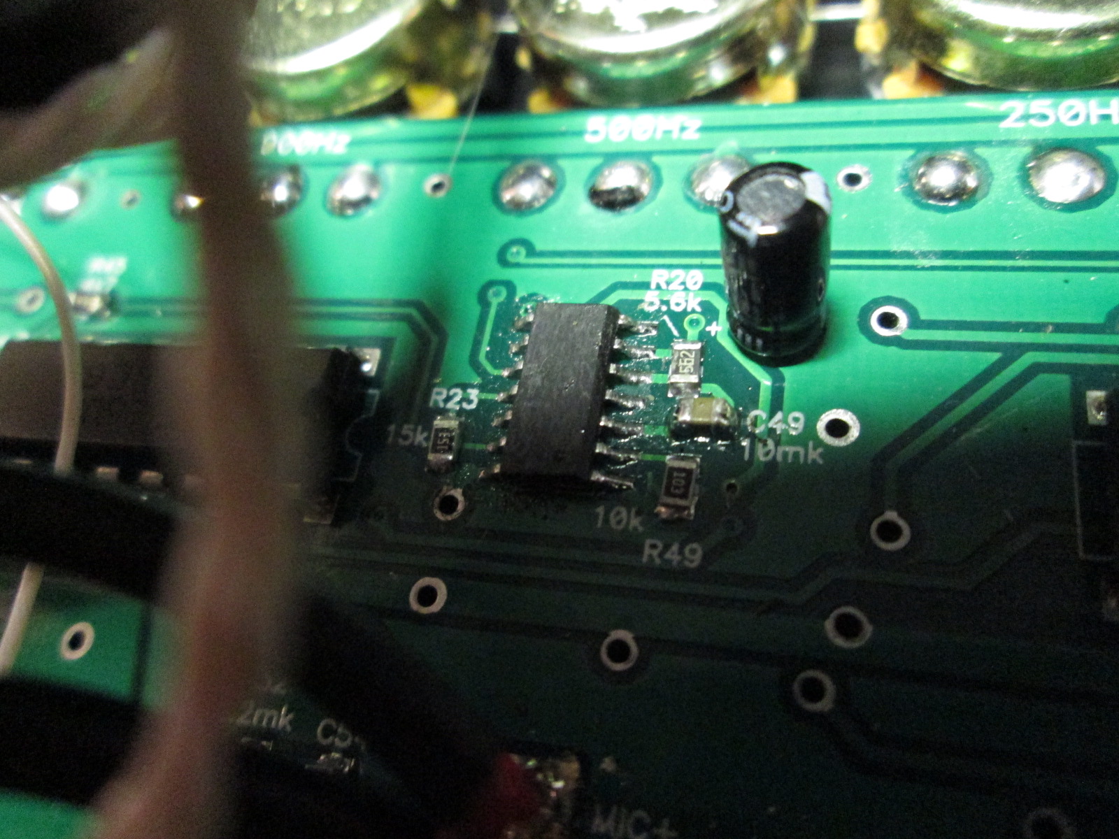

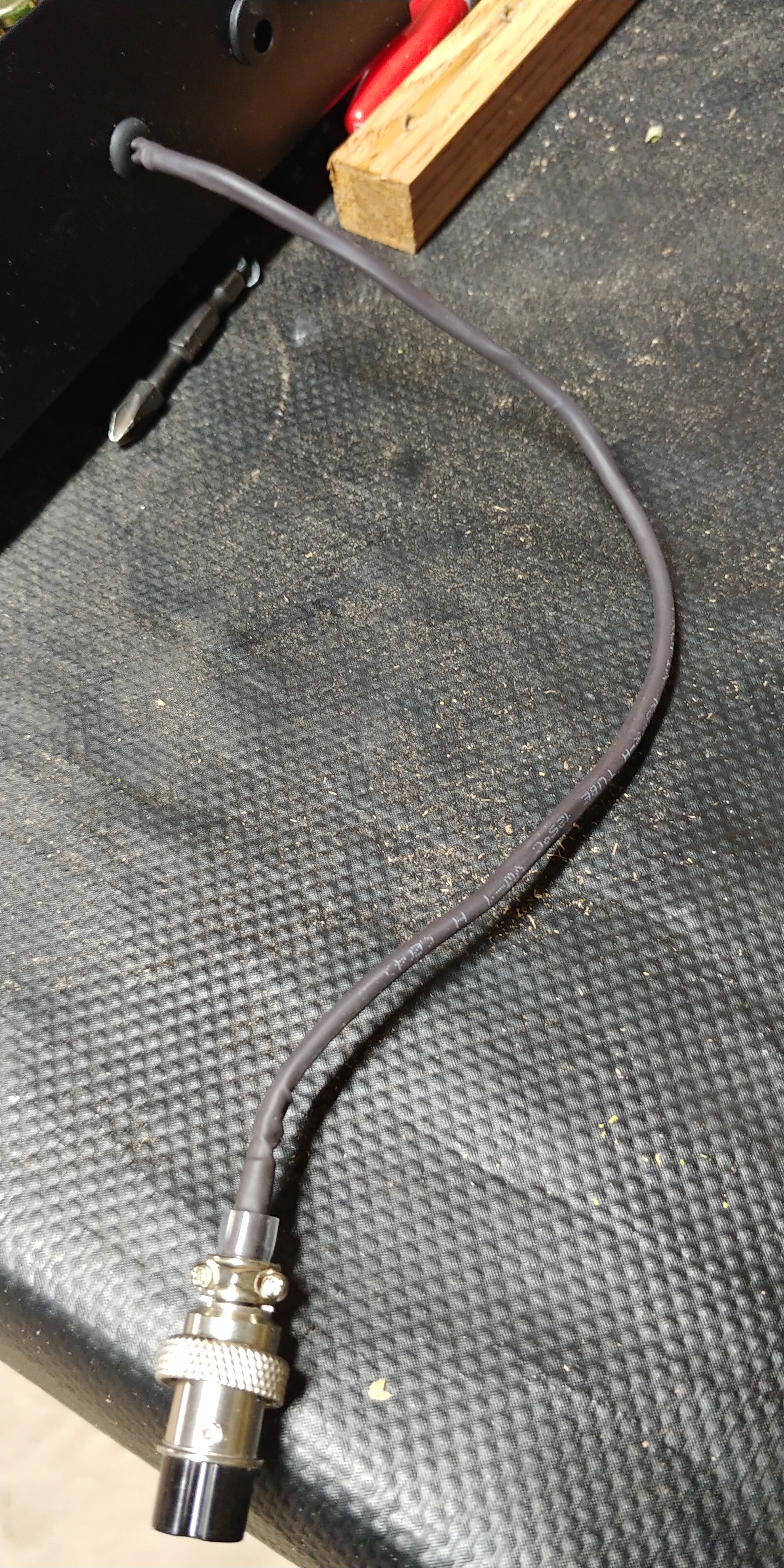

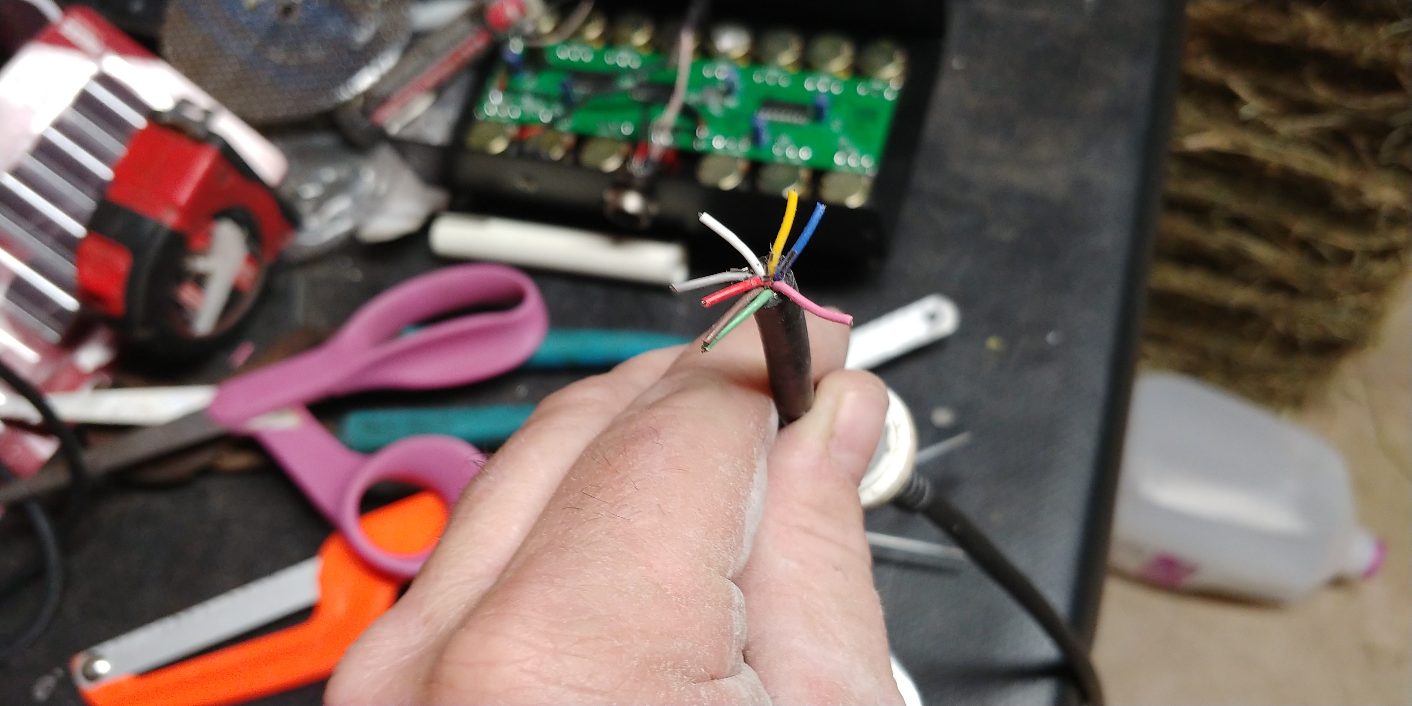

Just got mine. Not bad communication before the sale and havent tried after. The only things I see so far is the echo speed switch I dont think working and the headphone jack isnt working either. My other disappointment is the cord from the eq to the radio. Its just a bunch of wires in a piece of shrink tube that was never shrunk. I think I can harvest a cord from a ph testing probe I have. I think it will have enough wires. I havent really dug into it yet as im not the most electronically adapt.
Otherwise I like the unit. As was posted earlier its better than a lot of others. I like the gate since I have a window unit ac blowing 10 feet away.
Im running an aftermarket coffin mic as a power mic is too much. Im bidding on a non amplified d104 now as I think thats the mic i want.
Ill open this up and post a couple pics for you folks to play wheres waldo with.

View attachment 36610 View attachment 36609 View attachment 36611 View attachment 36609 View attachment 36610 View attachment 36611 Just got mine. Not bad communication before the sale and havent tried after. The only things I see so far is the echo speed switch I dont think working and the headphone jack isnt working either. My other disappointment is the cord from the eq to the radio. Its just a bunch of wires in a piece of shrink tube that was never shrunk. I think I can harvest a cord from a ph testing probe I have. I think it will have enough wires. I havent really dug into it yet as im not the most electronically adapt.
The switch isn't for echo the fast/slow switch is for attack time on the Noise Gate. Echo is controlled with delay and amount knobs.
Front jack isn't for headphones - it's a mic input jack. I have radios with VOX so I can plug in my headset mic cable into there and earphones RX into the radio and then I can talk using a boom mike headset and run my audio through the ur6qw.
Very cool for hands free operation! :)
