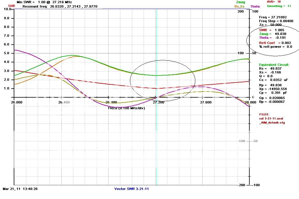

mrsuburban sent me a plot of his vector 4000 scanned with his vna,
sorry about the image size, its not clear if i shrink it:)

its the new vector eddie, im not familiar with his vna, i noticed the vswr ( or reflect for the bird watchers ) was very low @ resonance,

its the new vector eddie, im not familiar with his vna, i noticed the vswr ( or reflect for the bird watchers ) was very low @ resonance, as you know i bought my minivna after i retired my vector hybrid and put the i10k up so i cannot make comparisons against mrsuburban's plot,

i don't have a perfect dummyload to see how far out r is, i have a couple that measure within 0.1ohm of 50ohm at dc, the vna does not show a perfect vswr using either load, x is very low, if i remember right vswr reads 1:1.03, i don't think it would show 1:1.00 even if i did have a perfect 50ohm load.
