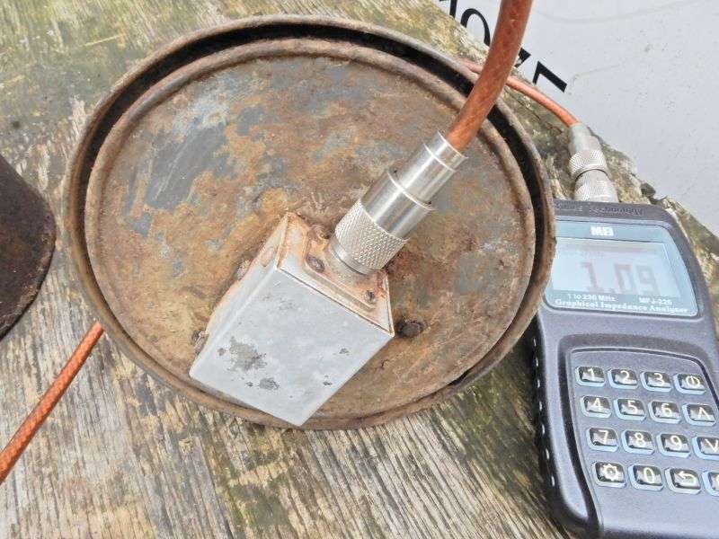

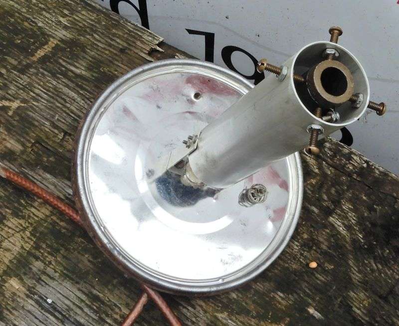

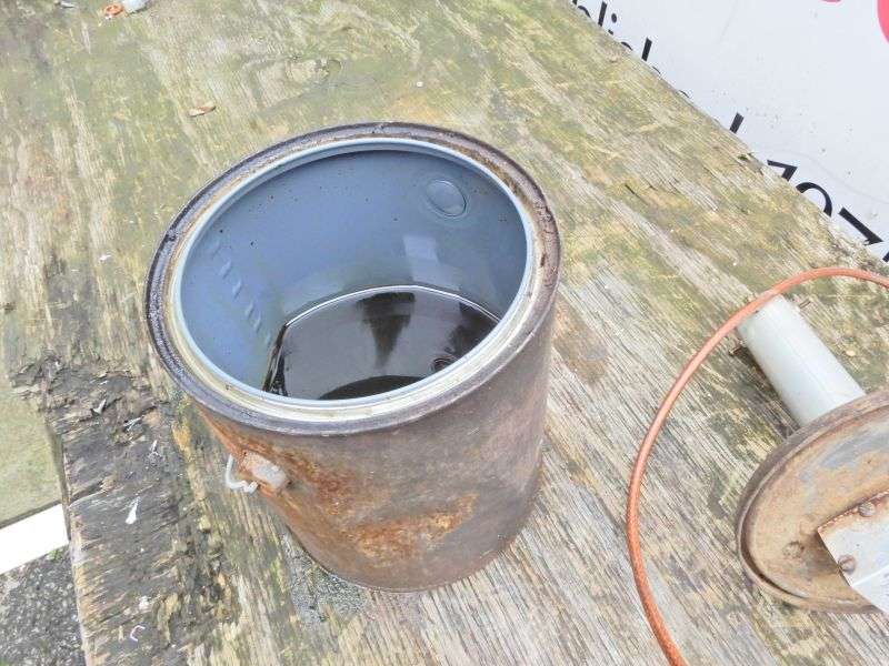

Finally dug this thing out and got a look inside. Just never needed it since I got it. Been in a corner, neglected for years. The top cover is grimy, but mostly with dirt and oil schmoo. Scraped off some of it, but not all by a long shot.
The oil inside is thick and nasty. Gotta dispose of that before it can go anywhere.
The inside is a lot prettier. Motor cleaner got all the oil off the inside surfaces. No visible oxidation that I see. Always a good thing.

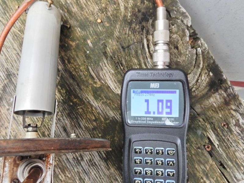

The silver plated surfaces should get scrubbed before putting any power into it. Pretty sure the black silver tarnish isn't all that conductive.
The analyzer is happy with it. Ohmmeter said 53 ohms.
I'll get it cleaned up to ship this week. Just tell me where to send it.
