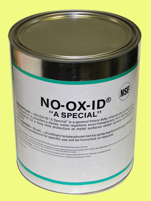

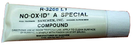

Try NO-OX-ID is the same stuff that Mosley Antennas been using for many years,you can apply a coat like varnish on your antenna and you can use the NO OX ID Paste to seal the connectors or tubing joins also works better than Noalox.
Check Mosley Antennas just for kicks :)
http://www.mosley-electronics.com/pages/parts.htm
