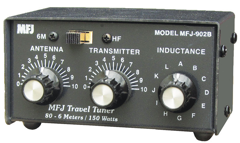

To truly operate at a low SWR across a full MHz you'll need a tuner or matching device and adjust it as you make big changes in frequency.
The MFJ-910 or 909 match boxes will work by adding capacitance for matching which is usually all that's needed for 10 meters.
There are small travel tuners that give more tuning variations which is better but either one will work.
There were CB match boxes made by Paradynamics and others but no longer available. These were cheaper and do work between 26-30 MHz. Might be available used on Ebay or elsewhere.
