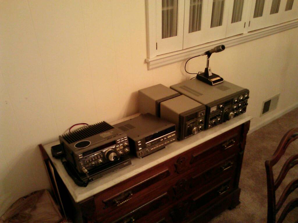

My Uncle went into a nursing home today and he sold me his Yaesu FT -757GX with FP -757GX power supply and FC -757AT antenna tuner. He also sold me his Kenwood TS -820 with VFO -820 remote VFO and SP -520 speaker.
I'm completely new to ham radio and am studying for my Tech license. I would like to listen to these units but only have a 2m antenna I use with my transceiver.
Can I connect the 2m antenna with these units to listen and receive only until I get another antenna?
Any insight you guys can give on these units is greatly appreciated. I am starting from scratch but have the Yaesu operating manuals.
Thanks in advance for your help!

You can plug in the 2m antenna but you won't hear anything but the strongest signals and of course don't xmit. You can easlly make a wire antenna that will work for hearing signals on many bands.
Both are excellent units if in working conditions but with your Tech ticket you will only be able to use 10 meters from 28.300 to 28.500.

Yes that is what I am talking about, there are several good sites that will provide good instructions. All in all the parts shouldn't cost you more then $30 and you can, once you get your ticket, work the world.
Check out Cheap Ham, they have everything you need.
Dipole will work fine.
How much room real estate do you have for antenna size?
If you are just going to use it for SWL purposes the antenna does not need to be resonant.
As stated before both rigs are good if in working condition.
I really like the Kenwood hybrid models , sensitive receive and great audio.
The 2 meter antenna will work ,sort of, ..... a simple dipole antenna will really bring the receive to life and they are cheap to build.There are several sites that will walk you through step by step on how to build a dipole .
As you are studying for your tech ticket also study for the general class.getting the general ticket will let you be able to really stretch the legs of the radios you have gained.
You have got your hands on 2 very nice HF radios,still alot of them in use today.
The kenwood rig you have is a real workhorse !! And the receive on that rig is simply great !! Not to mention they sound great on the air.
Hope to hear ya on the air soon !!
Reactions: 1 person
I strung up 75' of bare stranded copper wire and have it nailed to a tree about 10' up. After connecting it to a banana plug I am listening to a couple of conversations in Alabama - and I am in South Carolina. Pretty cool!
