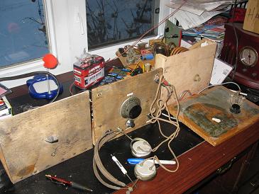

The 50l6 transmitter is to the left of my regen set. It has the single knob but matching finish. West of that (the regen in the middle) you can just see the 245 TNT I just built .

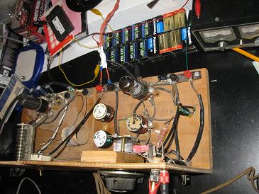

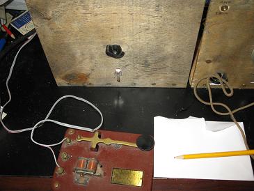

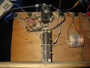

Here are Pics of my 50L6 TX , my regen and the whole ring dang doo.
