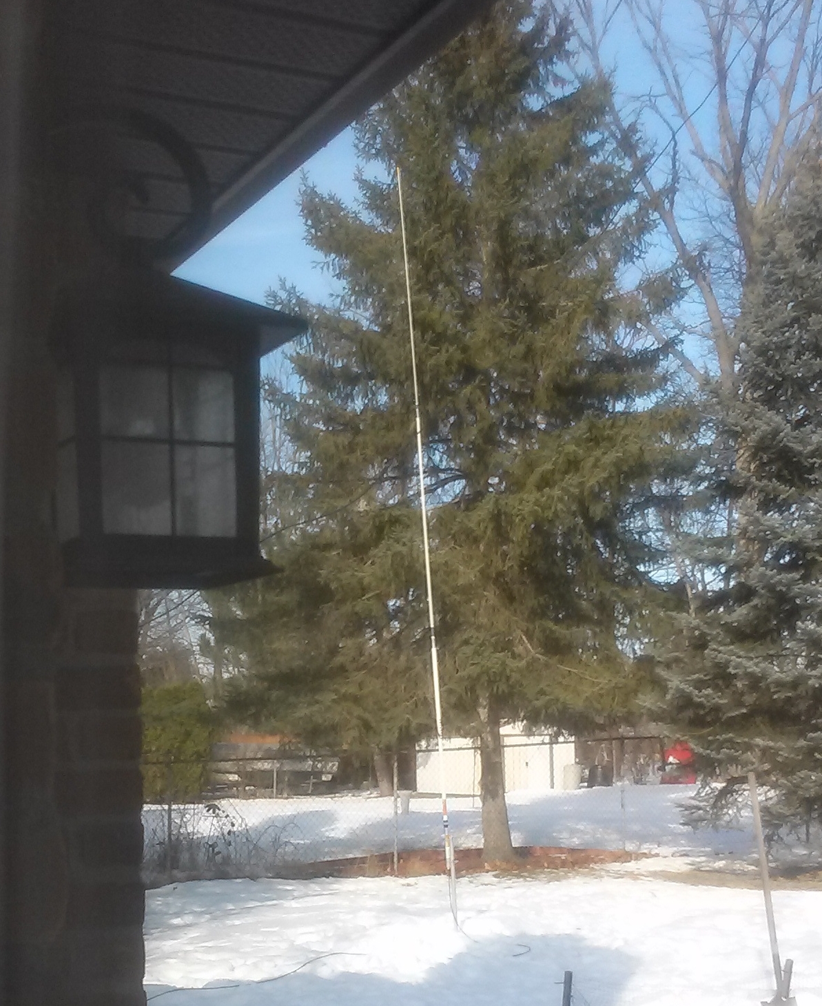

Got a Antron 99 installed temp to a 5 ft pole drove into the ground. (See picture below.)
Swr is perfect just as the manual states on CH 20 CB. With my Kenwood Ts-2000's auto tuner I can use the A-99 from 17-10 meters. Although at this height performance is not so good.

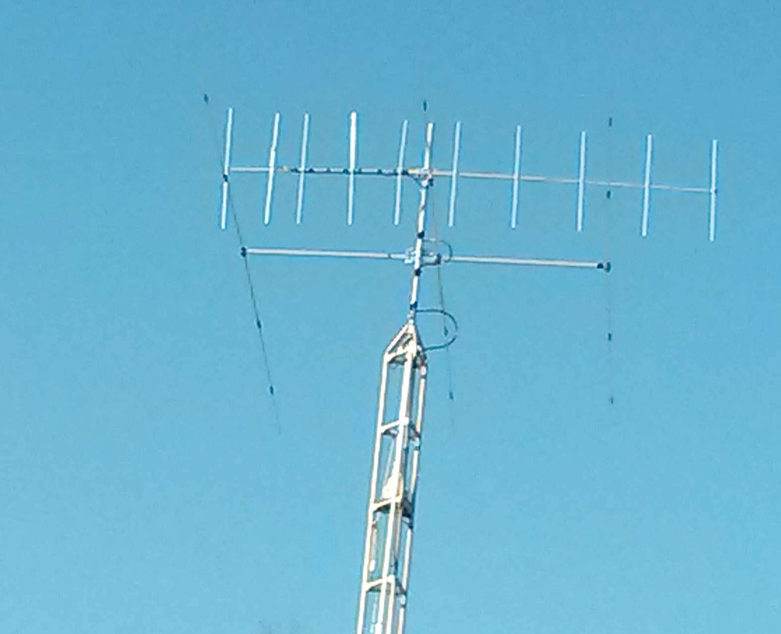

Wanting to mount it on my 40ft antenna tower but the only place for it is above my
Cushcraft A148-10S 10 element vertical 2 meter yagi.
I have enough mast coming through the Cushcraft yagi to connect the Antron 99 to so mounting isn't my concern. (See my picture below.)
Although the A 99 would be around a foot from the boom of the Cushcraft yagi.
What would the A 99 do to the performance of the Cushcraft yagi?
I guess I wouldn't know unless I tried it. The Cushcraft yagi is working perfectly now with a great Swr curve and I would hate to loose performance by adding the Antron 99 above it.
I may be able to lower the Cushcraft yagi down some on the mast but I cant go too much because my Sirio Sy 27-3 horizontal beam is mounted underneath. My Sirio yagi is also working perfectly now as it sits.
I also have to think about the idea of having 3 antennas on a mast coming out of a tower. It may be a bit much with the A99 flapping in the wind on top.
Although I had a Imax 2000 up above the Sirio beam before the Imax broke. I put up the Cushcraft beam in its place.
