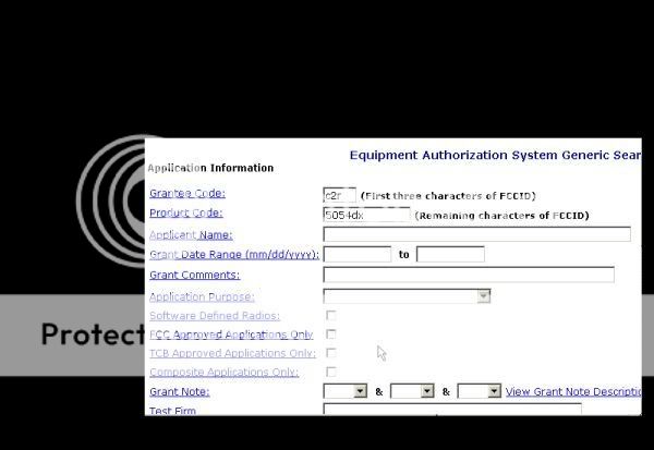

https://fjallfoss.fcc.gov/oetcf/eas/reports/GenericSearch.cfm?calledFromFrame=N
Type in the FCC ID # found on the back label as shown in the example below and then click search at the bottom. I searched the ID of the RCI 5054dx-

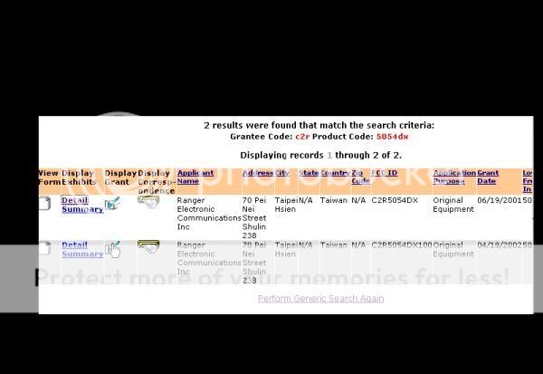

You will get a page with search results as below-

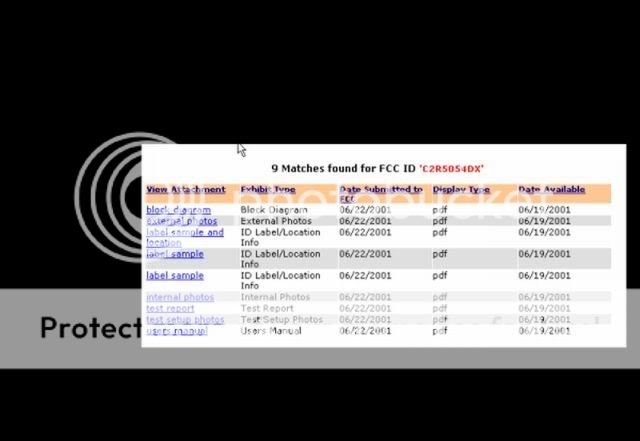

Then click on "details" and you will see all the documents available for your radio or device-
