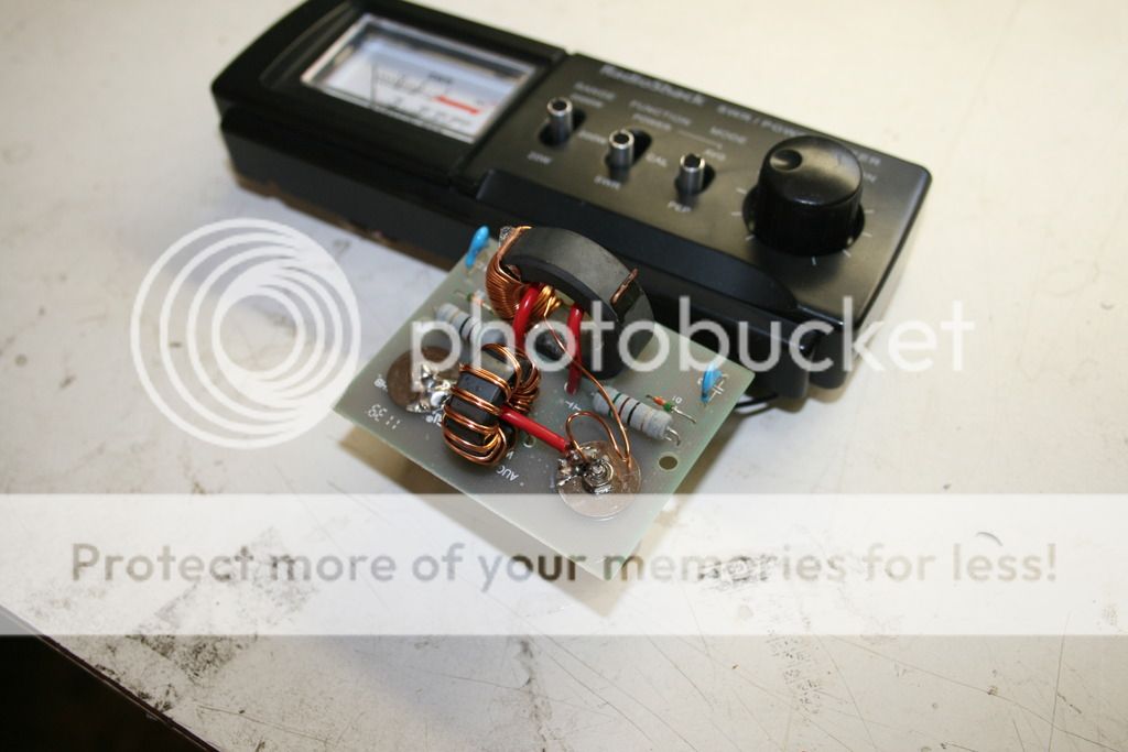

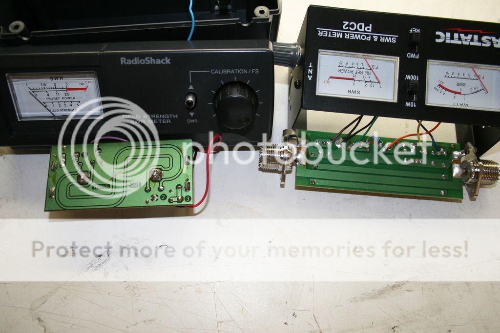

Hello,
I plan I making this 'calculating SWR meter'
http://www.qrp4u.de/docs/en/swr_meter/
I will be using it with my mobile export radio (Optima Mk3) that does not have a built in SWR meter. I was considering a MFJ 925 auto tuner because it has an audio high SWR warning. I have since decided against it because I'm only using this radio on 10 & 11 meters and it does not seem rugged enough for 4x4 off road use.
The antenna is a SST whip with a mast that is manually adjustable from 26.965 - 29.900Mhz. I want to use the calculating SWR meter to give an audio warning if the antenna is in the wrong position and the SWR exceeds 1.8:1.
Does if look like the circuit in the link above could be adapted to do what I want?
Will this circuit work from 4 watts AM to 150 watts SSB without readjustment?
Would someone please explain more about DR1 to me and how to make it?
Here are pictures of 3 different SWR meters I have. Could any of these be used as T1 in the circuit? I prefer to use the "strip lines' instead on the transformer because I think it would handle vibration better.
Thanks for the help :)
