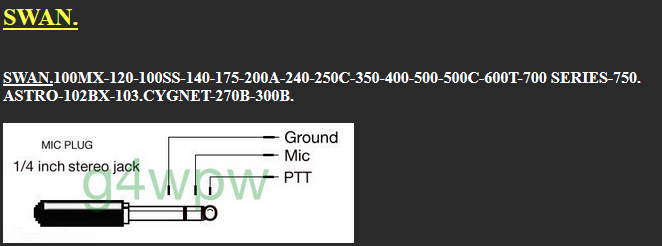

The information below may help. A DMM is your friend here. You only need to identify 3 wires on your Cobra "Coffin" microphone.
The link is where the info came from.
https://qsl.net/g4wpw/date.html
