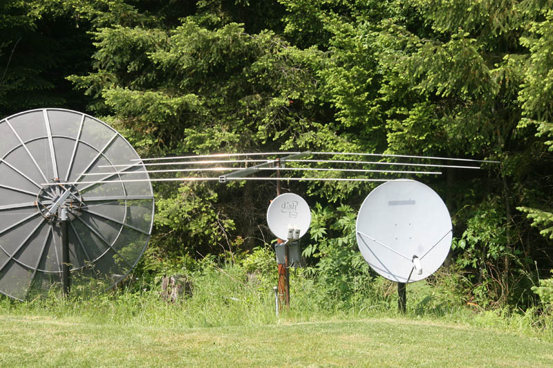

I got the hardware I was waiting for and so I started assembling the Yagi for testing

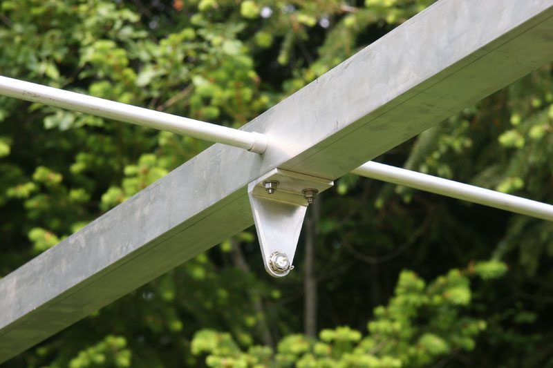

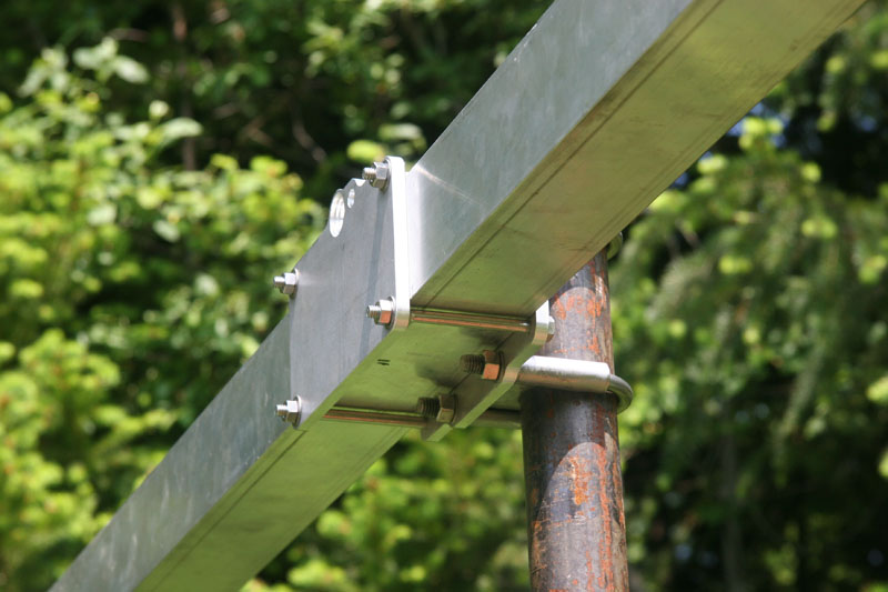

Here's most of the hardware I was waiting for. I made the sandwich plates.

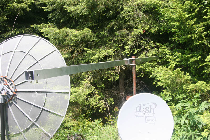

The boom without elements. 2.5" square 1/8 wall aluminum
One by one I put in the 5/8" elements. Had to stop and cut some tree limbs out of the way

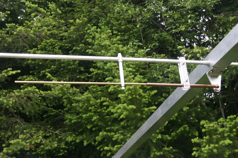

The last thing to go on is the feed/gamma attach point
I have to make up the cable I bought and attach the gamma match before I can test. I'm also studying for my General ticket so my time is getting stretched a little thin
This antenna will be tuned to the middle of the 10 meter band.

The Gamma match was set like this.
Brass rod fully inserted.
You can just barely see the marks I made on the element as I moved the ground strap in.
I wonder if cutting off the excess brass rod would make a difference?

Very good looking construction and ideas. You asked about cutting the extra end of the gamma rod beyond the dog bone connector. I can't say for sure, but there are opinions from folks that should know, saying that is a good idea and helps in a big way to reduces asymmetry problems using the gamma.
