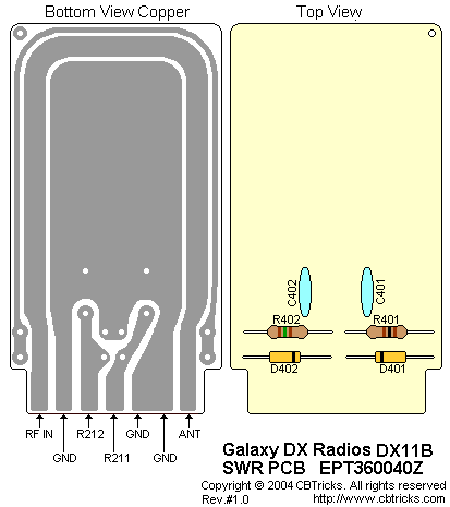

Galaxy DX Radios DX11B
SWR PCB (EPT360040Z)
Ref#
Description
MFR. Part No.
SWR P.C.B. EPT360040Z
Complete with Components
#T-106A-P05
P.C.B. SW 66X113X10.6
EPT360040Z
Ref#
Description
MFR. Part No.
R401
C/F/R P-TYPE 100 OHM 1/4W P
RCP141014Z
R402
C/F/R P-TYPE 150 OHM 1/4W P
RCP141514Z
Ref#
Description
MFR. Part No.
C401
C/C 0.01UF 50WV SL Z
CC0501037L
C402
CC0501037L
Ref#
Description
MFR. Part No.
D401
DIODE 1N60P
ED1N00060P
D402
DIODE 1N60P
ED1N00060P
