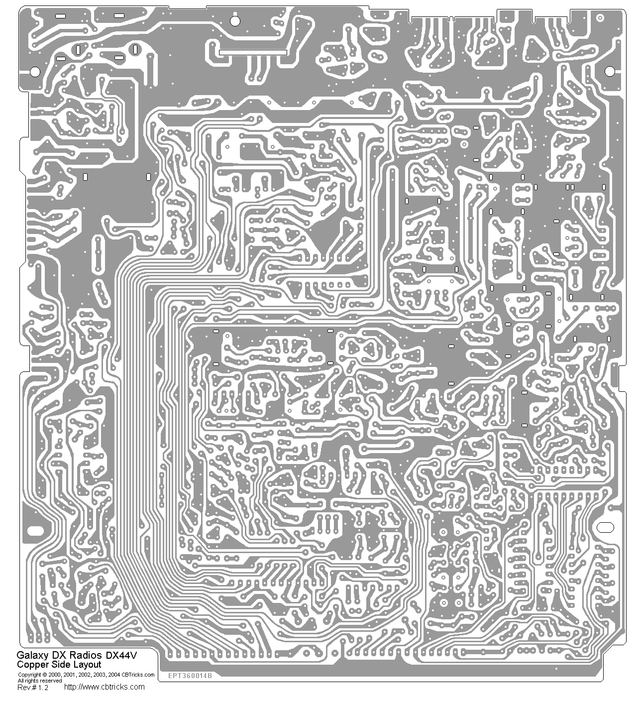

    EPT360014B Production up to end of 2002
    Main PCB Parts Layout Top View (EPT360014B)

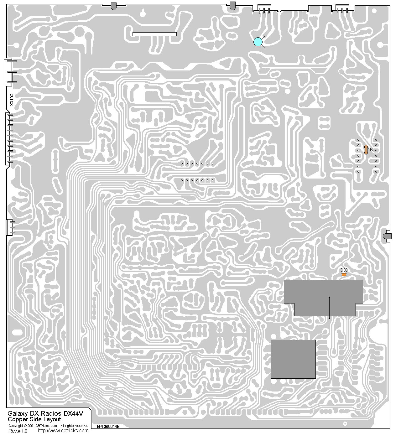

    Main PCB Copper Side View (EPT360014B)
    Main PCB Parts Layout Bottom View (EPT360014B)

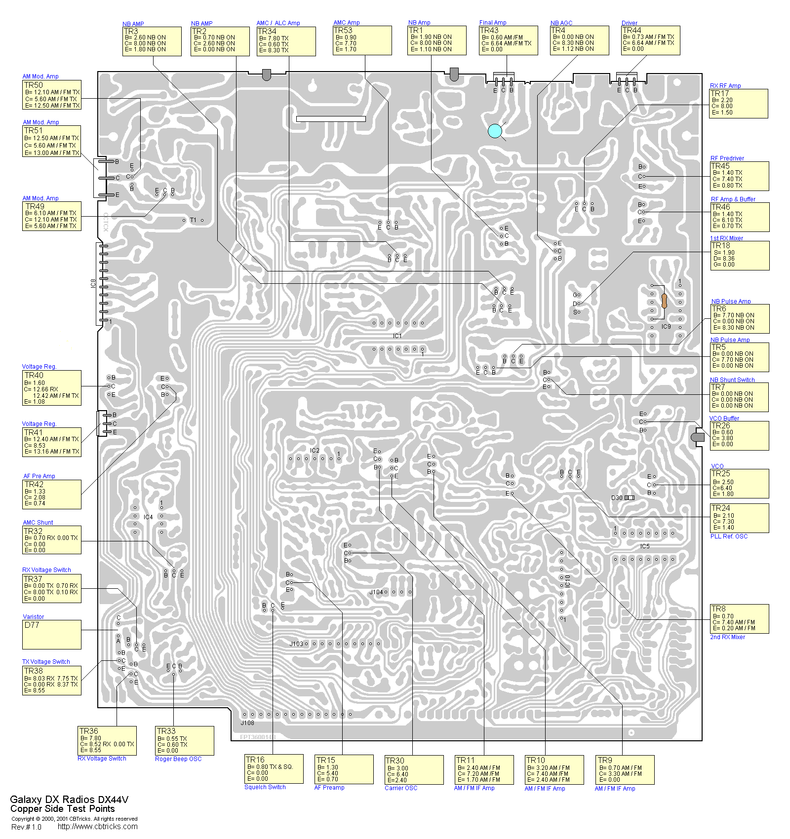

    Main PCB Test points Bottom View (EPT360014B)

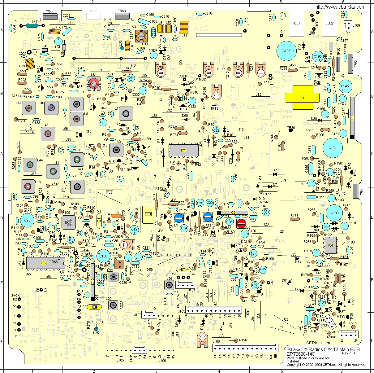

    EPT360014C Current Production
    Main PCB Parts Layout Top View (EPT360014C)
    Main PCB Parts Layout Bottom View (EPT360014C)
