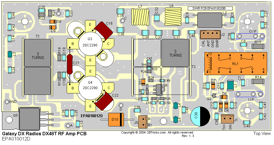

Galaxy
DX Radios DX48T
Documentation Project
CBTricks.com
RF AMP PCB (EPA010012D)
Trace Layouts
Copper Side Parts
Schematic
Ref#
Description |
MFR.
Part No.
RF AMP (SMD) EPA010012D (DX-48T) Complete with Components |
#T-141Q-P12 |
RF AMP P.C.B. 121x58x1.6tmm (d) |
EPA010012D |
