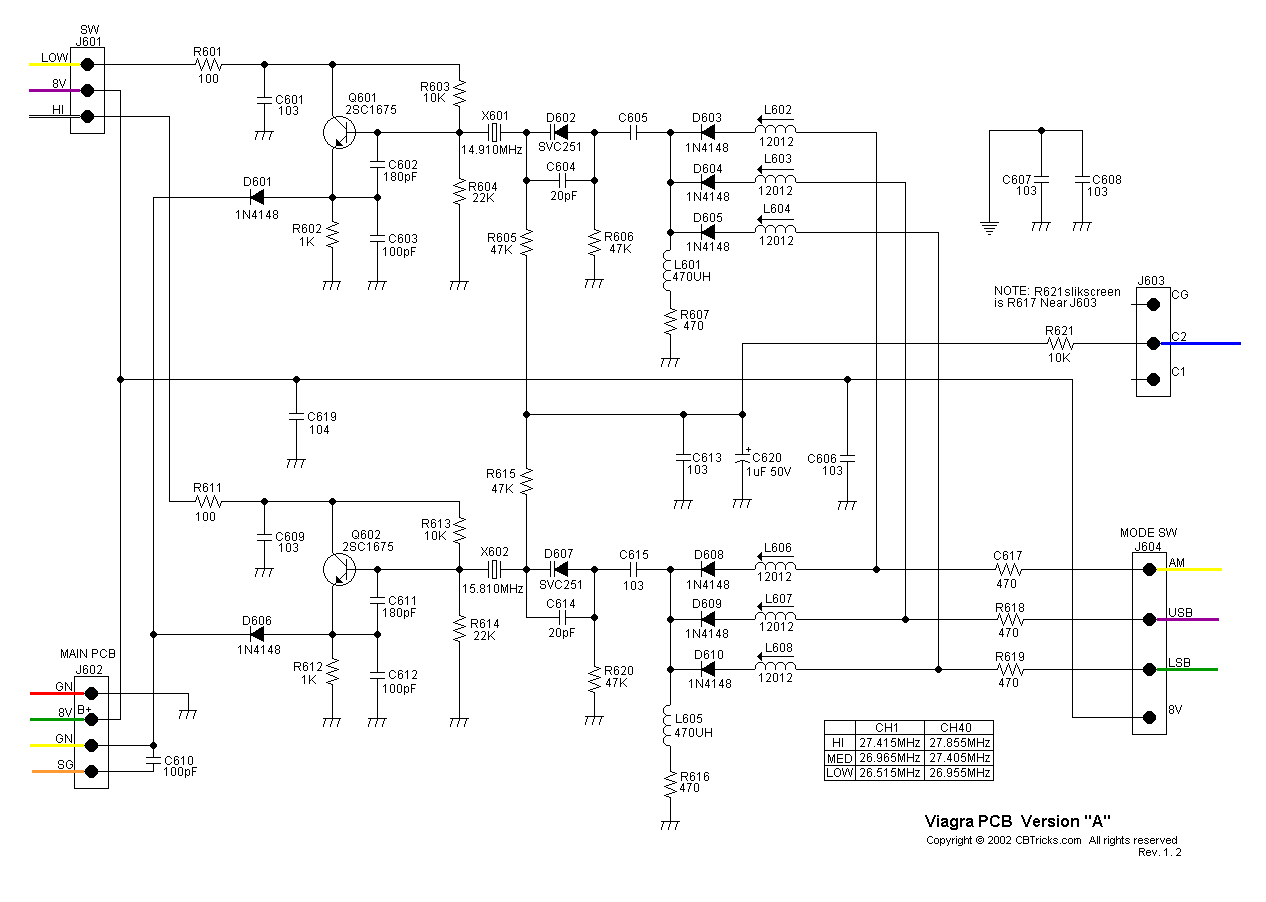

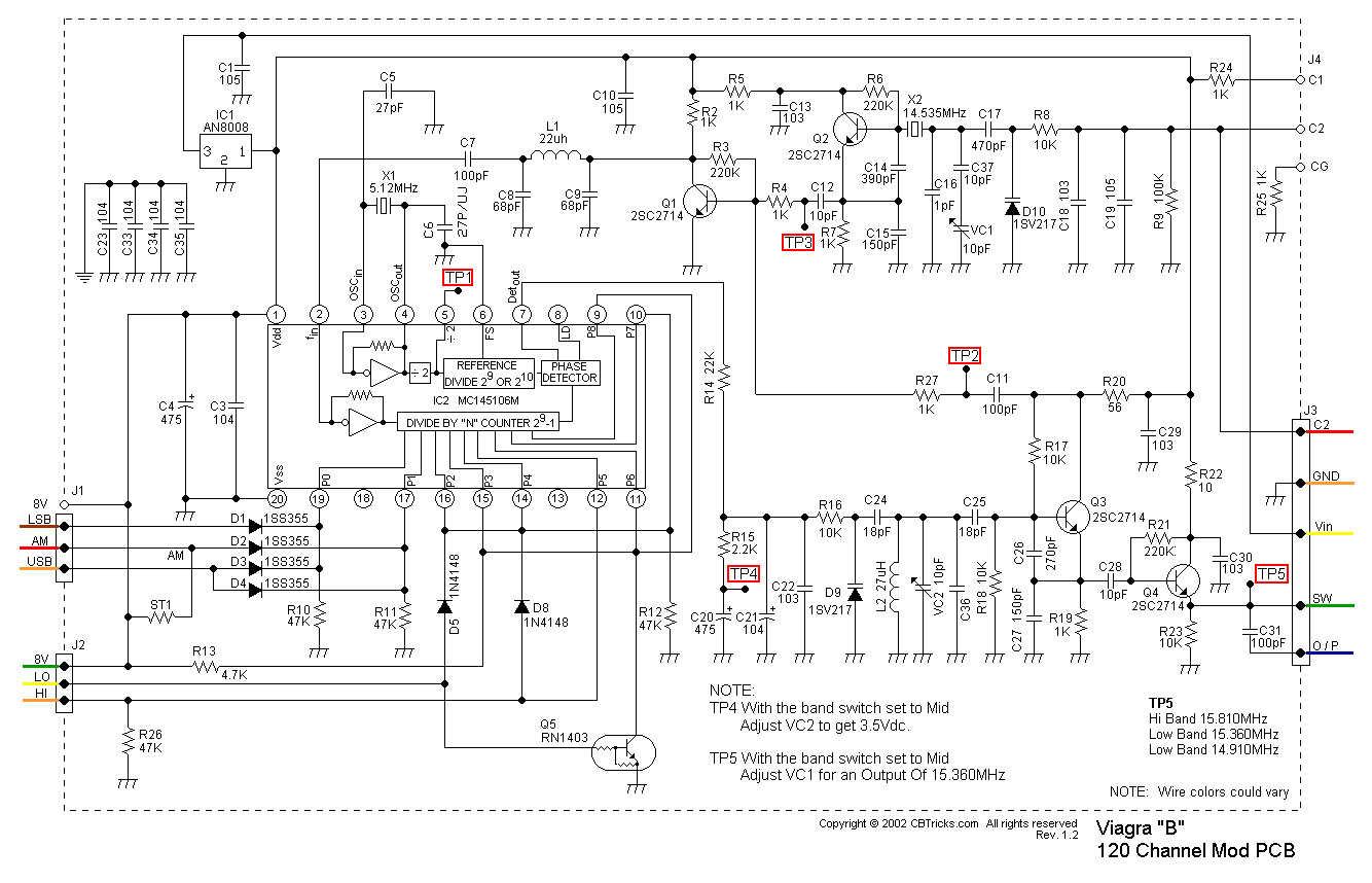

There are two versions of this PCB. Viagra "A" and a newer version called a Viagra "B".
The newer version "B" is much easier to install.
    Viagra "A" Board Frequency Modification
    Viagra "B" Board Frequency Modification

    Viagra "A" Schematic Diagram
    Viagra "B" Schematic Diagram
