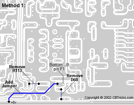

Method 1: |
1.
First, remove power to the radio. Remove the bottom chassis cover of the radio. |
2.
Remove R113 and D68 as shown above. |
3.
Connect a jumper wire between +8V and J9 pin F1. |
4.
Perform an PLL alignment as shown below. |
