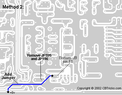

Method 2: | |
1.
First, remove power to the radio. Remove the bottom chassis cover of the radio. |
2.
Remove JP195 and JP196. |
3.
Connect a jumper wire between +8V and J9 pin F1. |
4.
Perform an PLL alignment as shown below. |
