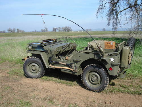

I always thought they looked cool mounted on the back of the old Willy's jeep.
