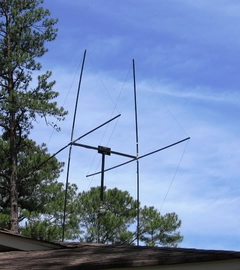

I am working on a 2 element quad antenna. I noticed that raising it a mere two feet higher brought the SWR down a little. It is only twelve feet from the ground to the boom while working on it. Can I expect a definite improvement on the SWR when I get it up to operating height, 30 - 35 feet?
Current SWR at present height is:
ch 40 2:1:1
ch 20 1:6:1
ch 1 1:4:1
See it here:
2 Element Quad

Do you have the usual DE/Reflector, or are you using a director (I've used both, they work the same)? What are the dimensions of the loops and what's the spacing. The feedpoint impedance of a quad (and a 2 element yagi for that matter) can vary quite a bit (40 to 125 ohms in the case of the quad) depending on the spacing.
What's your source for the 1/12 section? I don't see how that would provide much of an impedance transformation but maybe I'm missing something. If your VSWR was that high with a 1/4 wave 75 ohm Q section it looks like there may have been some other issues. These antennas are not usually hard to match to 50 ohms. On your 1/4 wave section, was the coax poly or foam dielectric, and how long was it?
Sorry for all the questions, I'm just trying to figure out why that didn't work in this case. I've used that matching method a bunch of times from 7 to 29 MHz and have never had a problem with it.

The reflector looks a bit on the short side, resonant around 26.53, whereas 5% lower would be around 25.895 (assuming a 27.185 fc). Other than that, it all looks right. According to the numbers I crunched the feedpoint impedence should be around 100 ohms at that spacing with a reflector cut for 25.895. And your 1/4 wave section was about 7 1/2 feet? Hmmmm..

Raised it to 28' at the boom, and the SWR did not improve.
ch 01 ---- 1:4:1
ch 19 ---- 1:7:1
ch 40 ---- 2:0:1
Now back to the matching at new height.

Yeah...
Well, three things you could do:
1. Make the reflector longer and totally re-do the whole spreader thing (a pain).
2. Lengthen the reflector using a stub.
3. Shorten it enough to make it a director (also a pain).
I'd vote for 2. And I bet you the 1/4 wave transformer will do the trick for you then.
I guess a 4th thing would be to load the reflector with a coil (Maco does that with their V Quad), which would be an interesting experiement, but the stub would be easier, and just tie it back toward the mast or along one of the spreaders. An analyzer or a noise bridge would help, but you can always just give it your best guess.

Are those spreaders movable (out from the hub)? If they are then lengthening the reflector might not be so bad.
How about some details on the boom, hubs, and spreaders? You took an original approach to that, and I'd like to see how you did it (and maybe steal an idea or two...). I just used angle aluminum for the hub and 3/4" square wooden spreaders I ripped from straight-grained 1x6s on my 11m quad. Yours looks like it may be just a bit heavier and maybe a little more of a windload, but more rigid than mine was.
Now if I could just manage to get a 20m quad up in the same place without it looking like a giant spider was eating the house...
I don't know if this is the first quad you've had, but I predict you will really like it once you work out the kinks.
