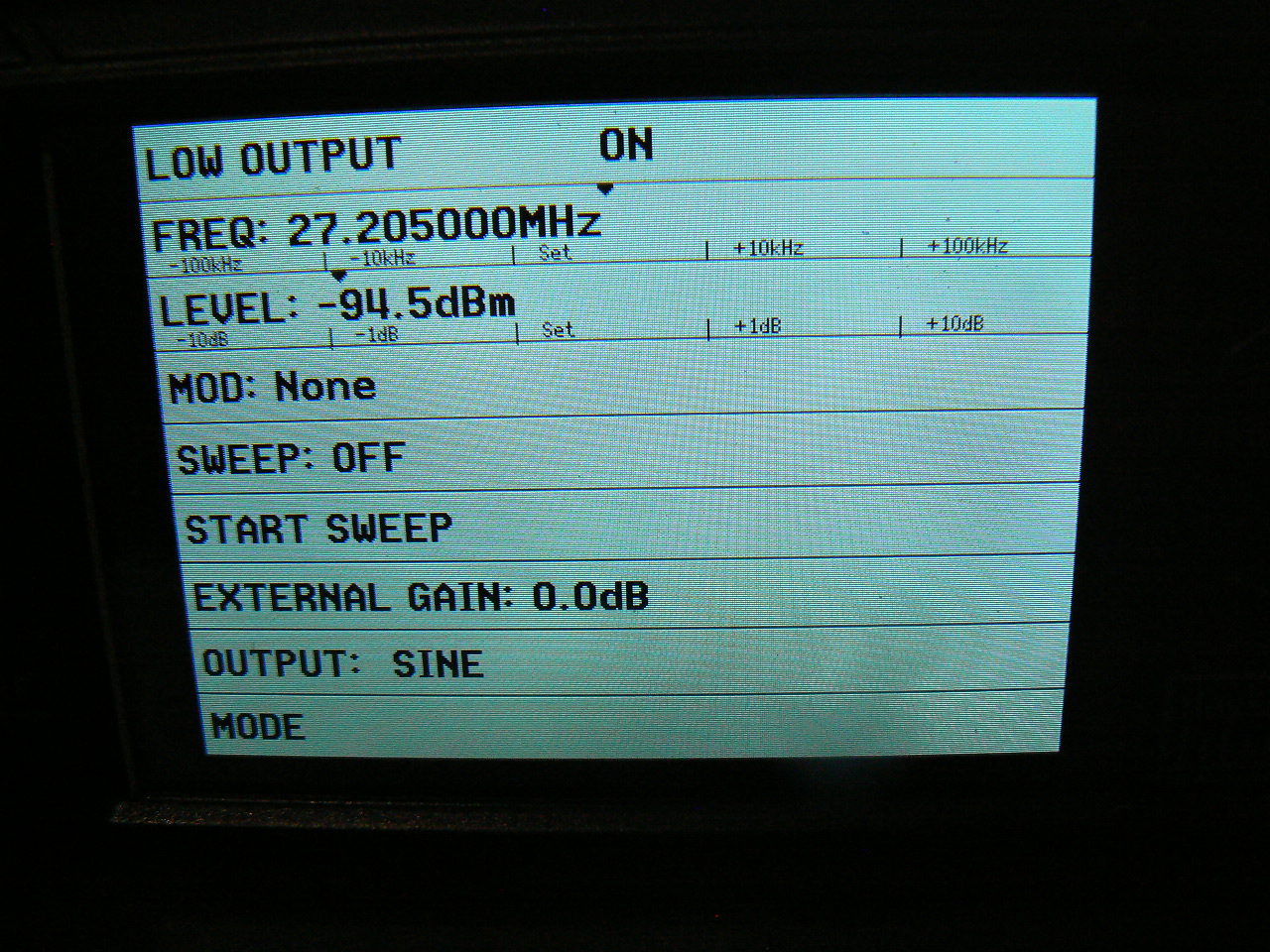

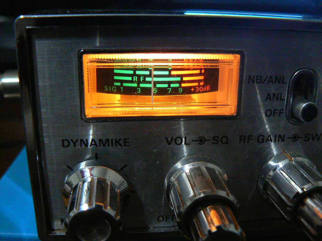

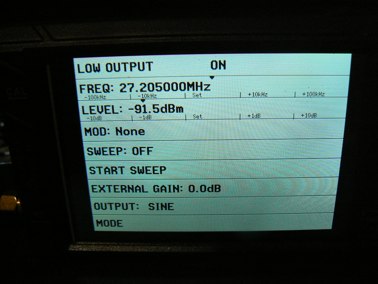

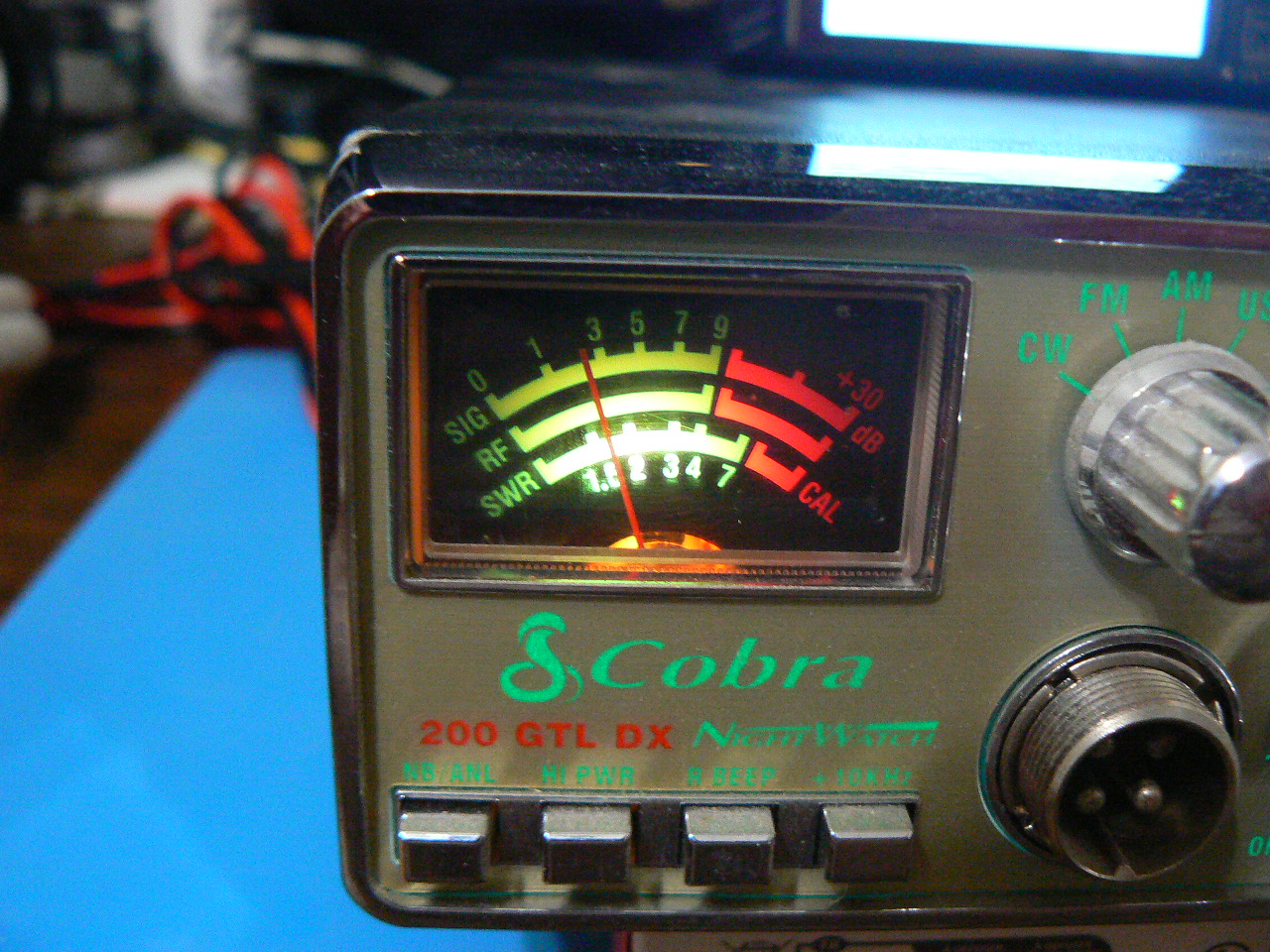

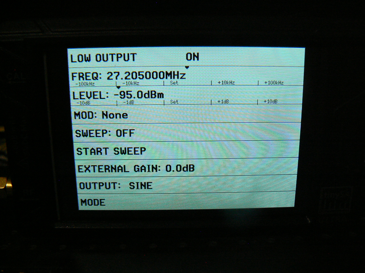

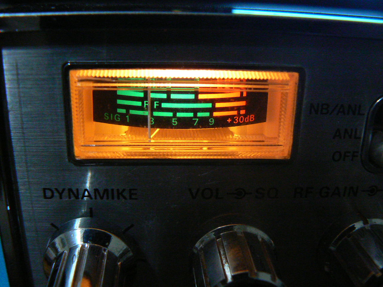

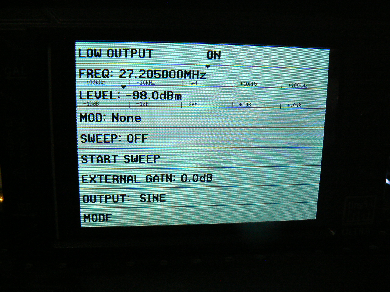

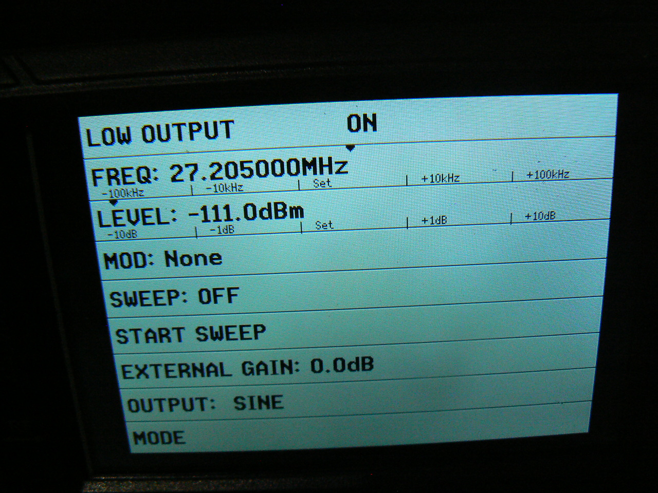

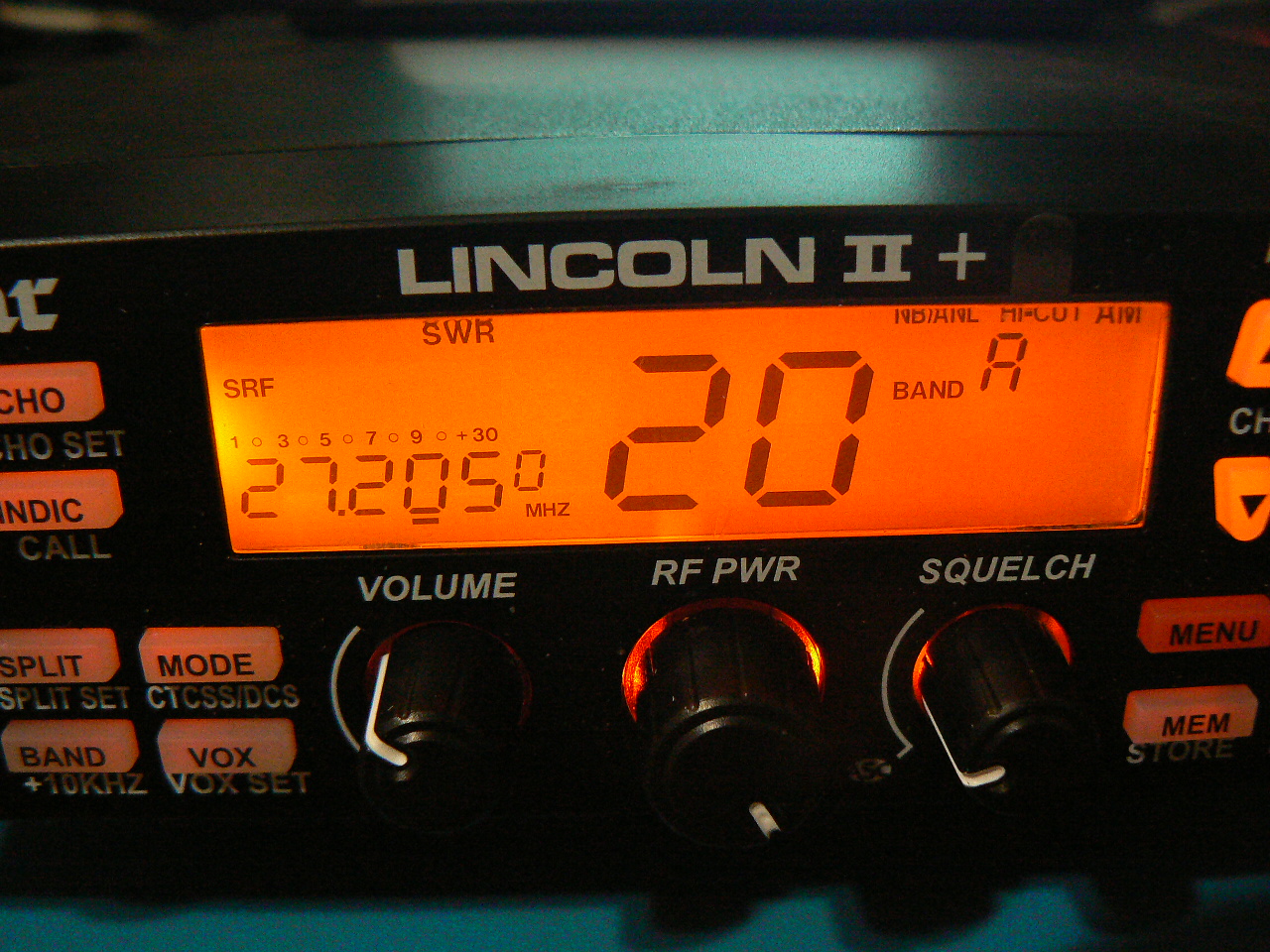

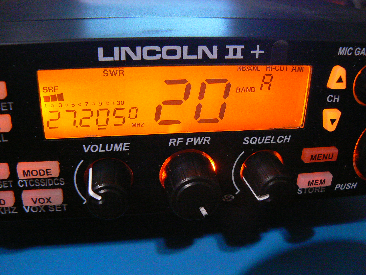

You know what they say...One accurate measurement is worth a thousand expert opinions...
Here are accurate S meter measurements on 3 different radios that I had close at hand. I didn't have a long enough cable to get both the Sig Gen and the Radio S Meter in the same shot. Freq. = 27.205, AM mode, un-modulated carrier.
Cobra 200 GTL:
-98 dBm = S1 (S meter pic is fuzzy)
-95dBm = S2.5
3dBm = 1.5 S Unit

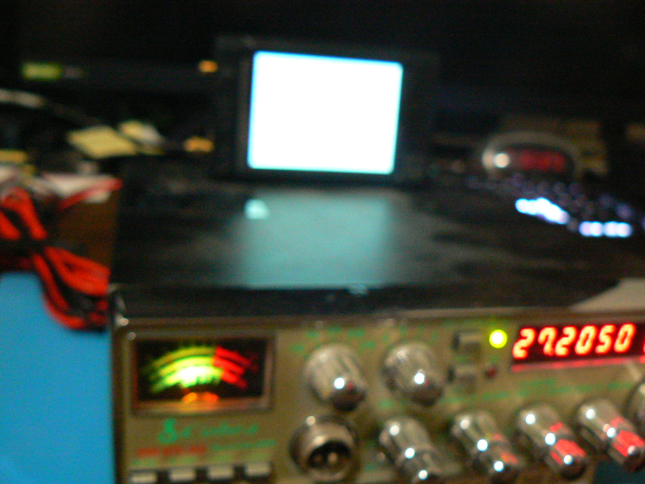

Cobra 148GTL:
-94.5 dBm = S2.9
-91.5 dBm = S4.8
3 dBm = 1.9 S Unit

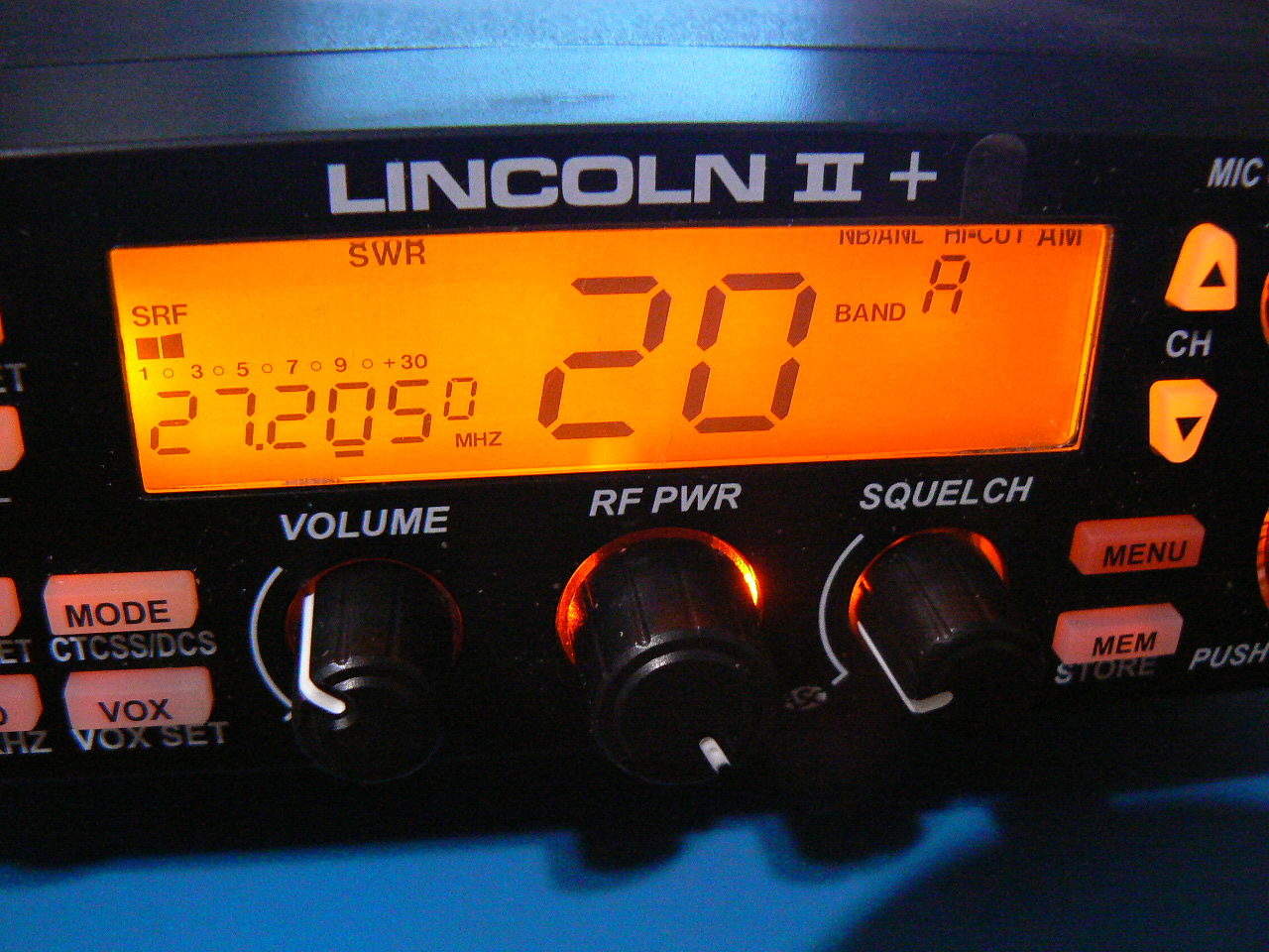

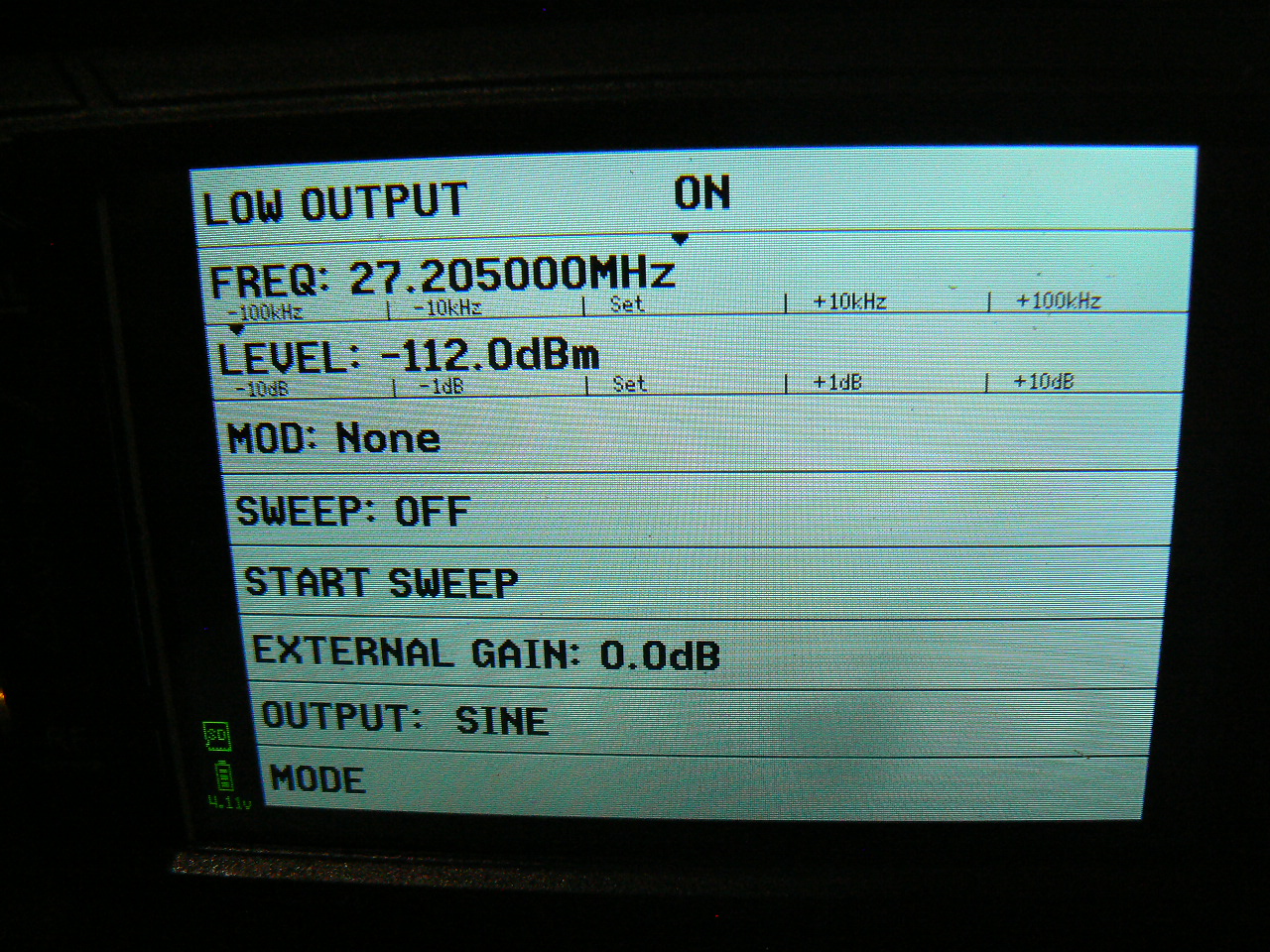

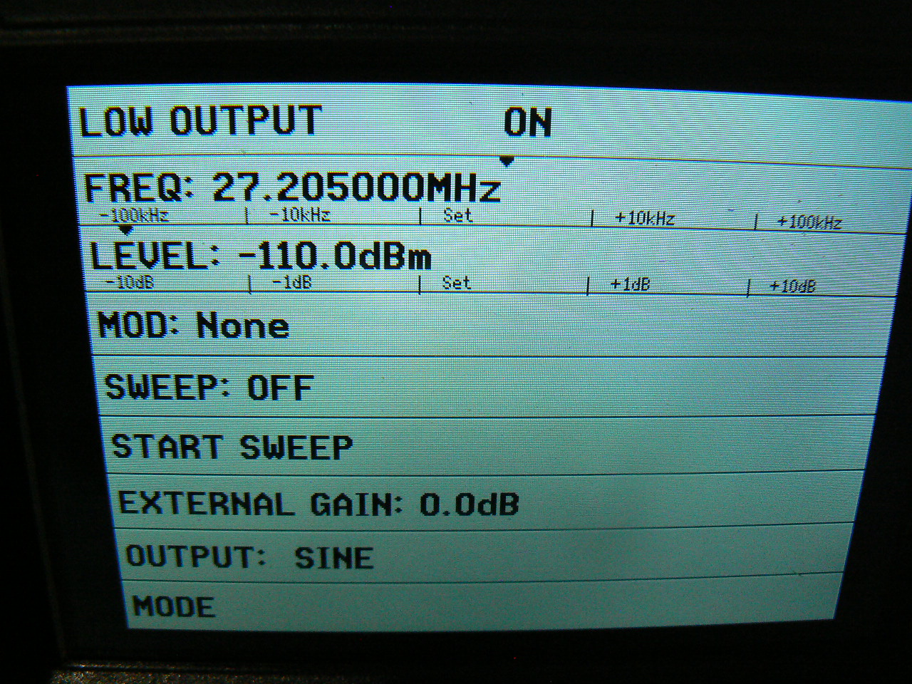

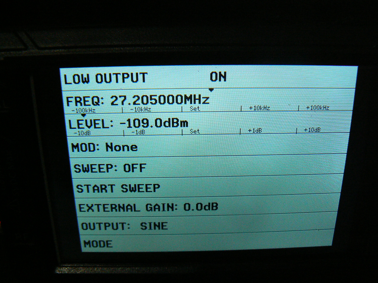

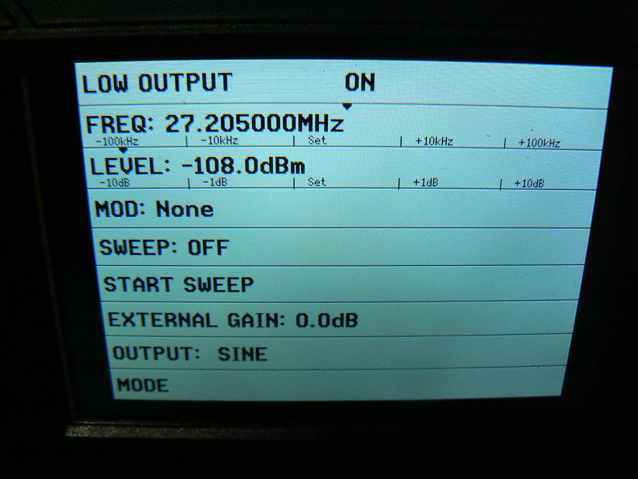

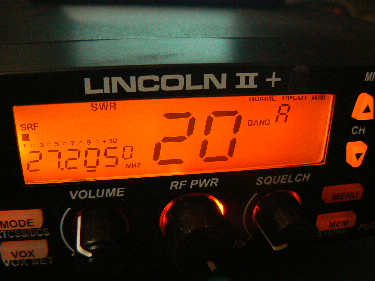

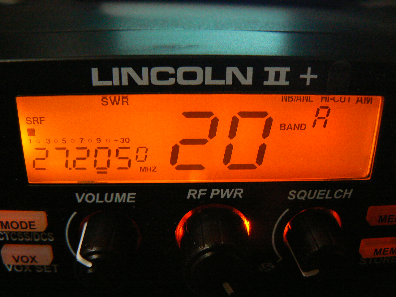

Lincoln II+:
-112 dBm = S0
-111 dBm = S1
-110 dBm = S1
-109 dBm = S2
-108 dBm = S3
-111>-108 dBm = 3 dBm = 2 S units
I can do this all day...
For any S meter that has a single point calibration (S9), analog or digital, they will show these characteristics for low signal levels for two reasons.
1. The further you are from the calibration point, the more inaccurate the meter becomes.
2. The main reason for this behavior is the AGC. At low signal levels, it doesn't kick in. By S9 levels, the AGC is strongly clamped down.
For radios that have multiple calibration points for the S meter - some Qixiang built radios, maybe others - this isn't an issue.
