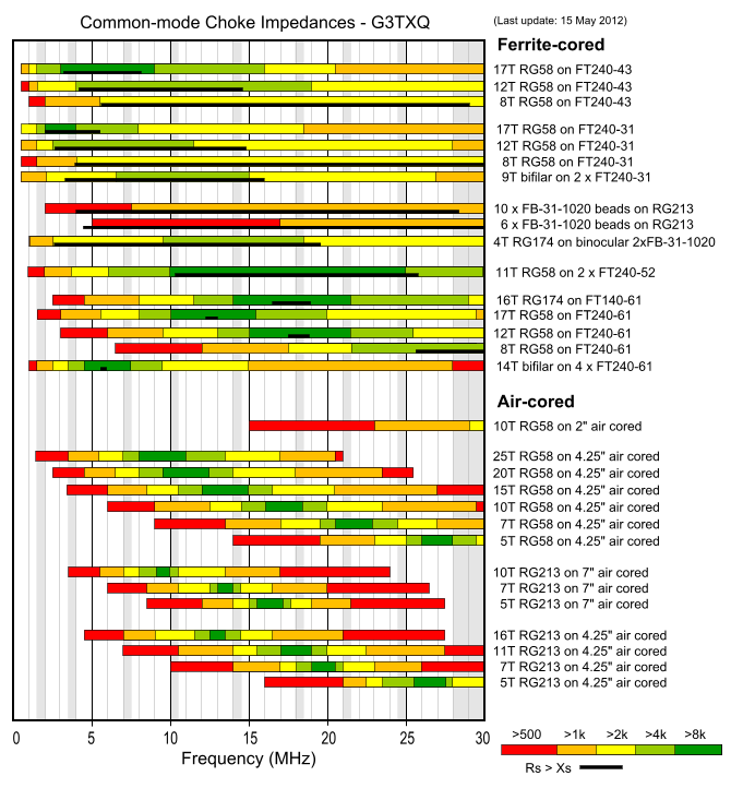

I do have a 12t on 3" choke up there now, and it actually did help with rf in my stereo. I have no idea if it is causing any other issues though.
I also got a ground rod sunk at the mast, but I haven't actually grounded anything yet. I'm not sure what I want to use for equipment grounds yet. I should probably figure that out and get on that.
No idea what that is choking but it is nowhere near actual measured air wound chokes for 11m, chances are its choking lower, much lower. 5 turns of RG58 or RG213 on a 4.25" diameter is perfect for 11m, covering 26-28MHz giving 8k Ohms or more. Add just 5 more turns and it drops the frequency of that 8k Ohms down to 16-18MHz . Choose one of the below. Ideally you'd want one where there's a black line under the 11m section as well as that means its resistive, not reactive choking but it does mean using a ferrite core.
Ground rods don't do anything for RF grounding.

What ferrite mix is the proper one to use?
I just don't understand the antenna needing the coax. Why wouldn't it use the metal mast? Is the wound choke completely ineffective, to the point that 8.5' of coax is still part of the antenna? If so, and I put ferrite chokes at the feed point, the vswr would be off the chart. Maybe I will try ferrite at 8.5', then insulate the antenna from the mast and snap some ferrite at the feed point.
yes you are right that the antenna will just use the mast if you choke off the coax.
I did not know how your antenna was mounted so i did not assume that there would be 10 or so feet of mast below the antenna in your setup.
isolating the antenna from it's mast and then choking the coax at the proper point is the ideal installation, but can be hard to accomplish.
you can't just insulate the connections between the antenna and the mast, as the current on the shield of the coax will just induce itself right back on to it.
you need to use some sort of non-conductive substrate for your mast.
MFJ and DXengineering sell fiberglass telescoping masts that would be perfect for your set up, but they will run you a couple hundred bucks.
(if you choose to get one, buy one longer than you think you need, and then just don't use the top two sections, as they are only 3/4" and 1" anyway)
then install a lightning arrestor (a real one, not the 10 dollar ones) right where the coax meets the ground, and install your 4 foot ground rod there. then run coax from the arrestor to the radio.
this way, the only link from your antenna to your system is the coax, which is running through the lightning arrestor.
the thinking here is that any strike close enough to zap you will melt the coax and hopefully the arrestor stops the rest.

LC, I was working under the presumption that the first 100 & something odd inches of the mast metal acts as the 1/4 wave for the half wavelength over 1/4 wavelength design of the A99 (if no GPK used). I guess i'll have to read the frickin' manual (if i can find a copy) and see if they mention anything at all about the topic, lol I don't know :).
It would if it were 102 inches long but it isn't, its longer. As it increases in length over 102 inches its impedance increases for 27MHz. By the time you get to 204 inches or a half wavelenght long the impedance of the mast is several thousand ohms. Current takes the path of least resistance so if the impedance of the coax is less than the mast the current will flow more down the coax. That's why you use a RF choke so the RF current sees the braid of the coax as hopefully higher impedance than the mast or radials and sends the current down those instead.
