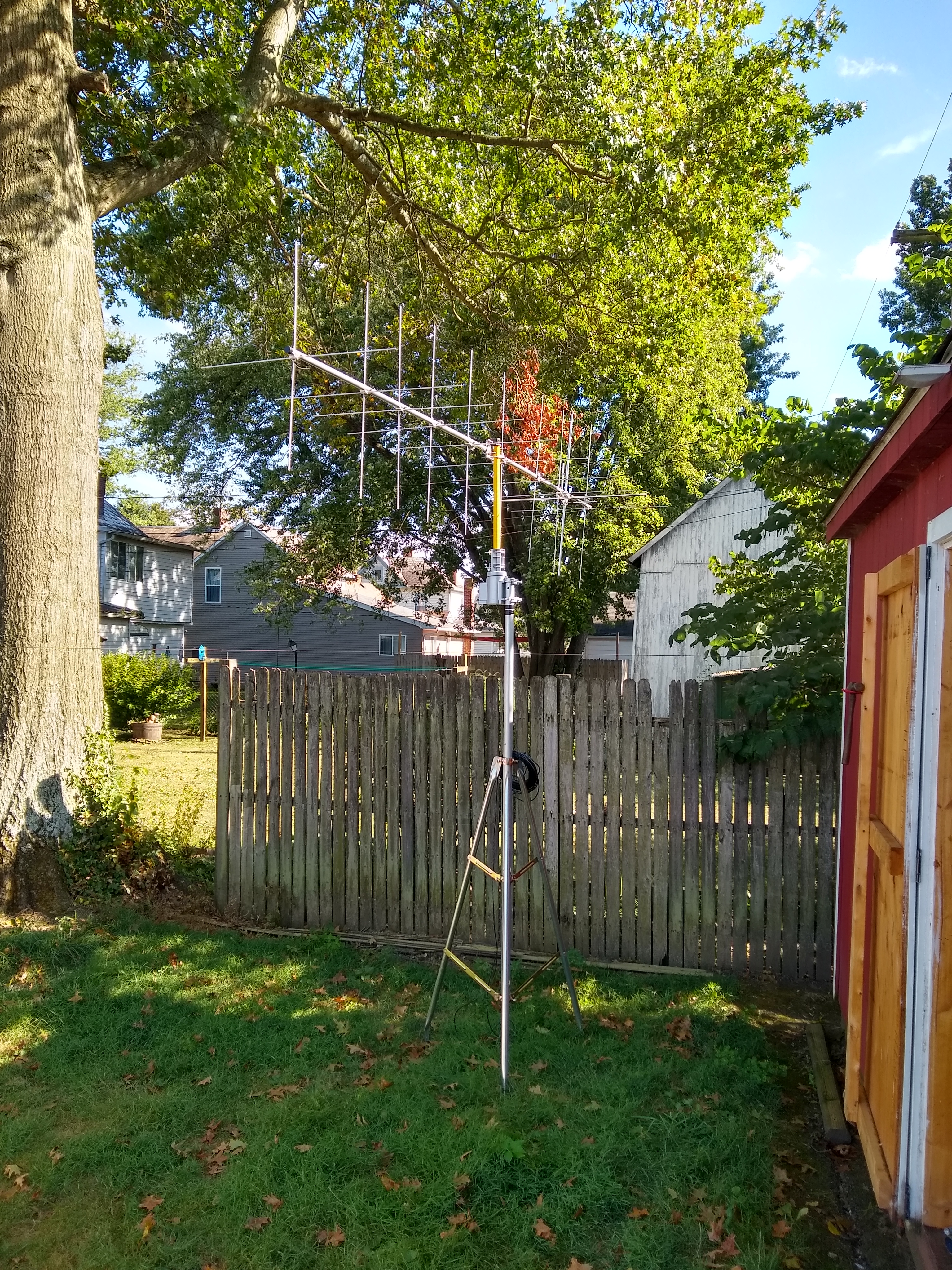

I'm thinking this will be the final tweak. I cut 3 foot from the the 10' mast. The tripod is 5' tall. The bottom the the vertical elements are over 7 feet above ground.
Just need to orient the antenna with rotor, attach and weatherproof my dual feedline jumpers of LMR-240 and do a final tune check. I like BJ Radionuts idea of detaching coax and lifting the mast and antenna out together. I'm thinking I can make up a couple of other antennas mounted on a mast and swap them out at my leisure. I like that idea.
This configuration seems like it will be sturdy enough. I swapped the Yaesu rotor for a lighter TV rotor to reduce weight stress. Boxed it up for later.
Anyways, isn't it somewhat glorious? If this setup performs good, might spring for a 2 meter amp.
I did a tripod mount many years ago with a three element beam I guy wired the tripod bolted on 2 piece clamps that had eye hooks used that black guy rope with turn buckles and ran the other end to the rafter at the facial boards with eye bolts The guy wire were long but it went thru a blizzard. Uesed that black tar Kent seal on the bolts and under the Tri pod Was up 8 years never leaked
I've installed several tripods in my day, I suggest using a butyl rubber roof sealer (not in a tube but it is a sheet) under each pad, this will seal very well, drill straight through it with the lag bolts. As it gets hot it softens and follow the bolt into the wood. Great stuff, I believe Home Depot carries it still.
Hope you have access to the attic just in case when drilling for the lag bolts you miss a roof truss/joist. If you do miss one I would I would pull the lag back out, install a 2X4/2x6 across the joist/truss then drill the lag back down into it.
The rule of thumb is the mast should only be 3ft above the top of the tripod, you could get away with 5ft depending on the antenna.
