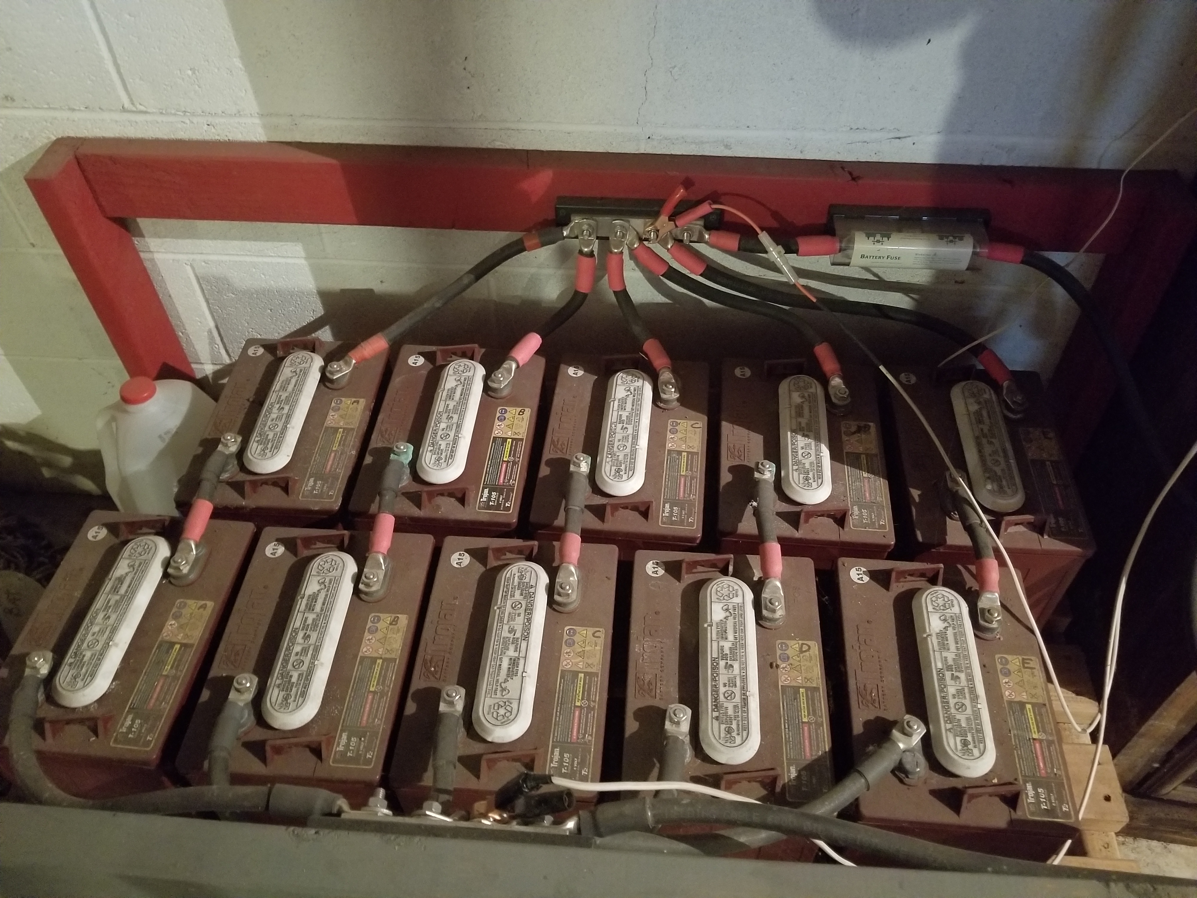

This seems to be the best tool for those high amperage connections.
Harbor freight sells something similar.
I have this one and the next size bigger too. I make my own battery cables and high amperage cables for car audio sound systems. The hydraulic crimper is essential for a proper "cold weld". I used to solder my big connections (00 and 0000) and it is hard to do correctly without damaging the insulation on the cable. The biggest mistake I see people make is to use a connector that is too big and then it doesn't smash down correctly. The proper size should barely fit.
