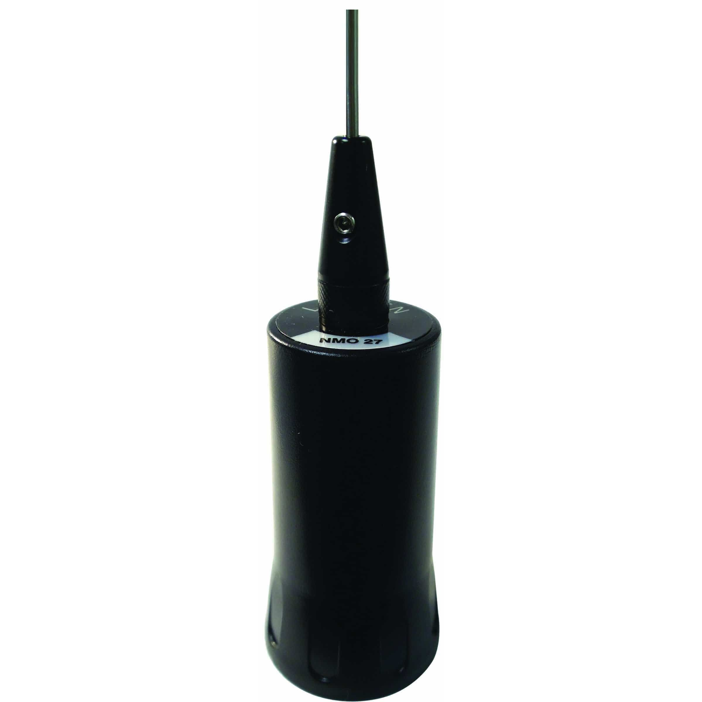

I believe Larsen makes an 11 meter antenna that would fit your nmo mount.
That would be the Larsen NMO27. Decent antenna and is about four feet tall, maybe a few inches longer, and has the NMO mount.

I had the Larsen on my old crown Vic, never had any luck with it, never could getgthe swr set where I liked it and driving down the road I always got "picket fencing". And it's only has a power handling of 200 watts, which a two pill will be easily pushing that limit. In fact I still have the antenna. And the coax is rg58u?and I'm planning on running LMR400.

You had picket fencing on 11m? Wait.......you meant when you had a 2m radio? Well ANY antenna will give you picket fencing on 2m FM as it is simply a function of the shorter wavelength and the FM capture effect and happens when the signal is rapidly fading in and out of the radios capture threshold. I have used Larsen 2m/70cm antennas and they are great. In fact pretty much every emergency vehicle is outfitted with one because of their quality. The wrong sized hole you had wouldn't help matters and has nothing to do with the quality of the antenna itself. I suggested the NMO27 because your post read as if you wanted an 11m NMO mount antenna to replace the 2m NMO mount antenna but now you say you want to get rid of the NMO mount altogether.

The Larsen nmo 27 will not handle the wattage I'm gonna throw at it. We're talking within six months over 1k pep.
