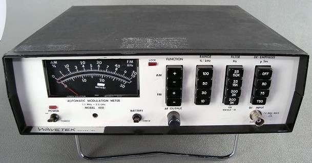

This is the kind of meter I was referring too. I have had this one for many years and plan to keep it for many more. When new they were the better part of $1000. It does AM modulation to 100% and FM deviation to 100KHz.

Yeah but it doesn't do FM deviation which is important to me and requires a computer connection so it is not really portable. I can pick this up and go. It will run on an internal battery pack as well. Besides that there was no such thing as REA when I got the Wavetek. (y)
