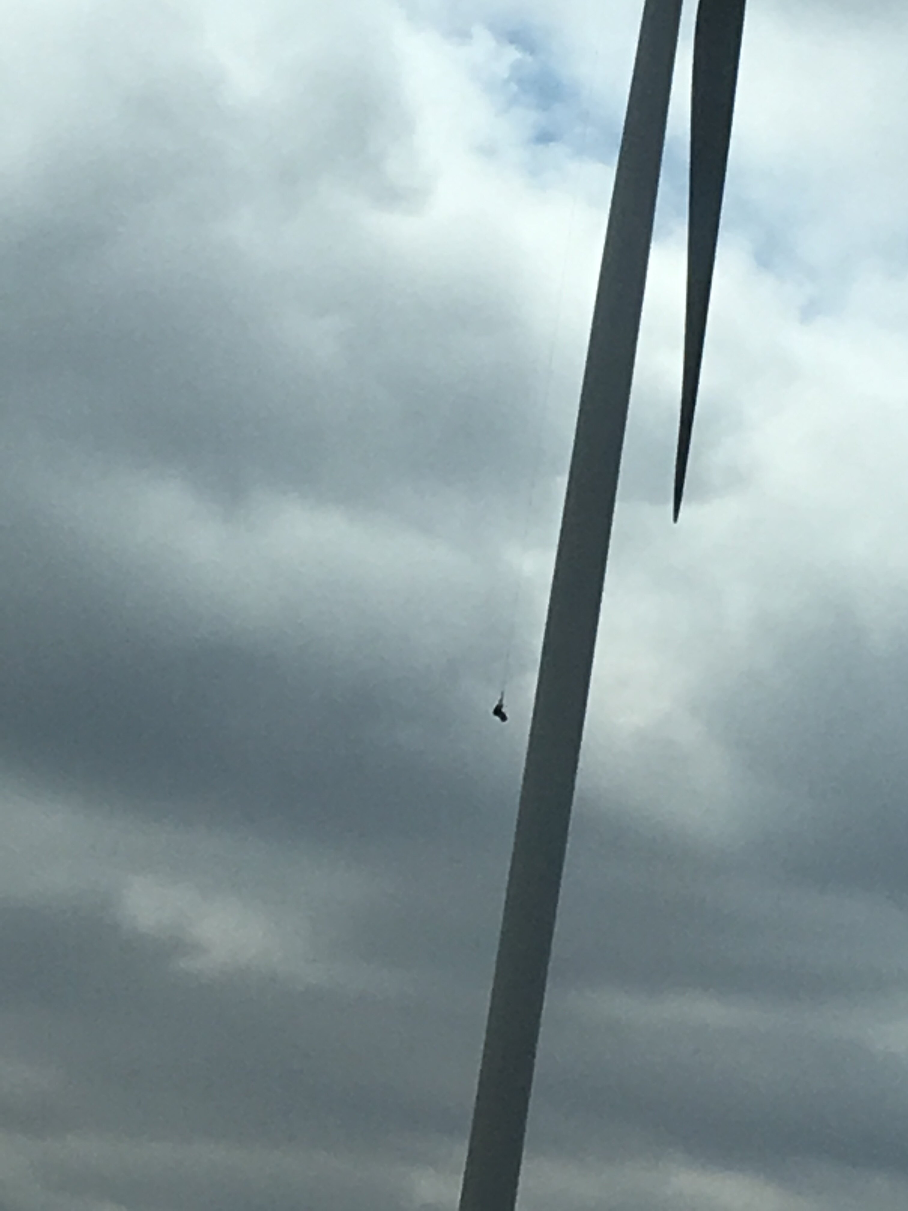

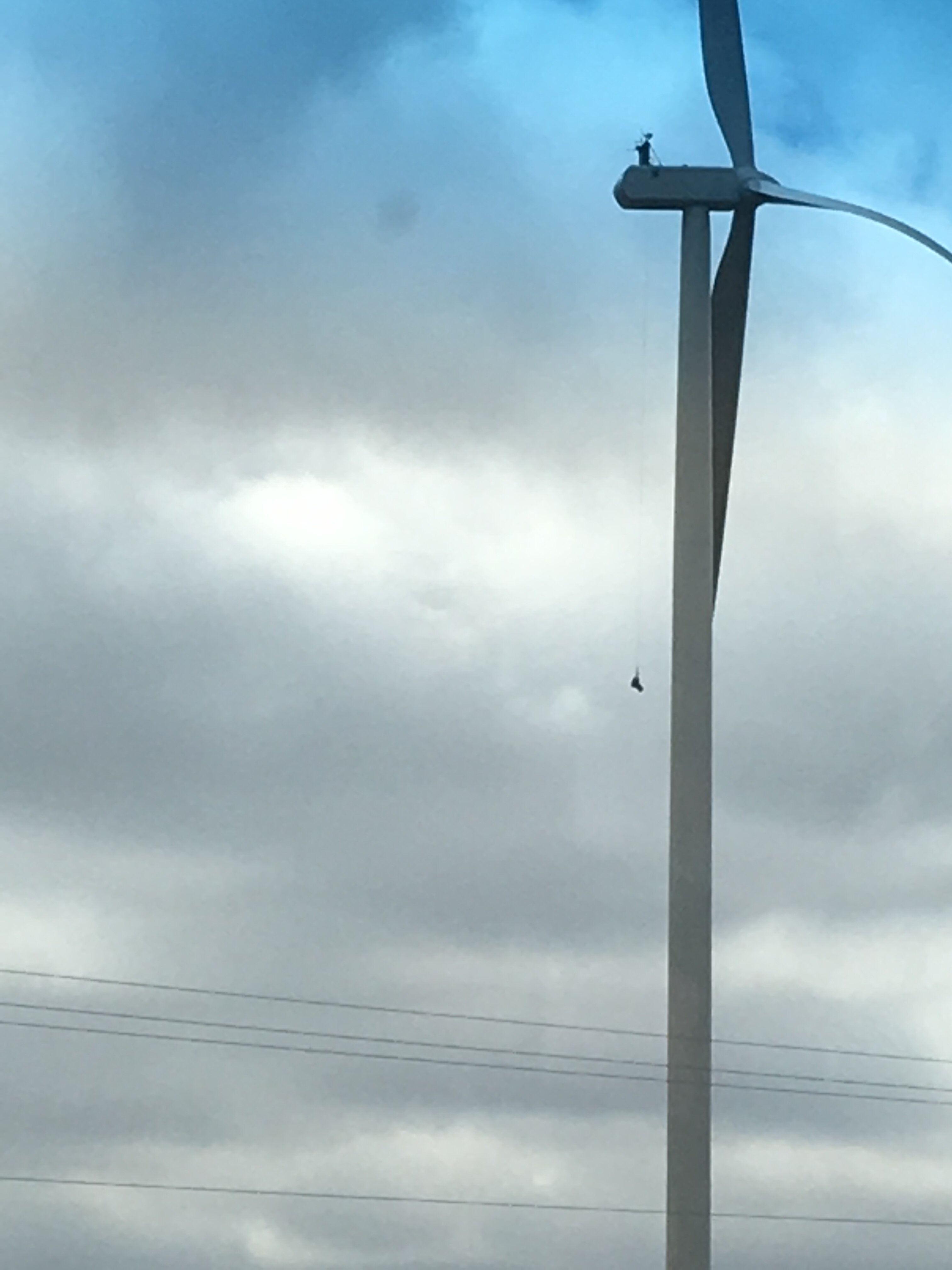

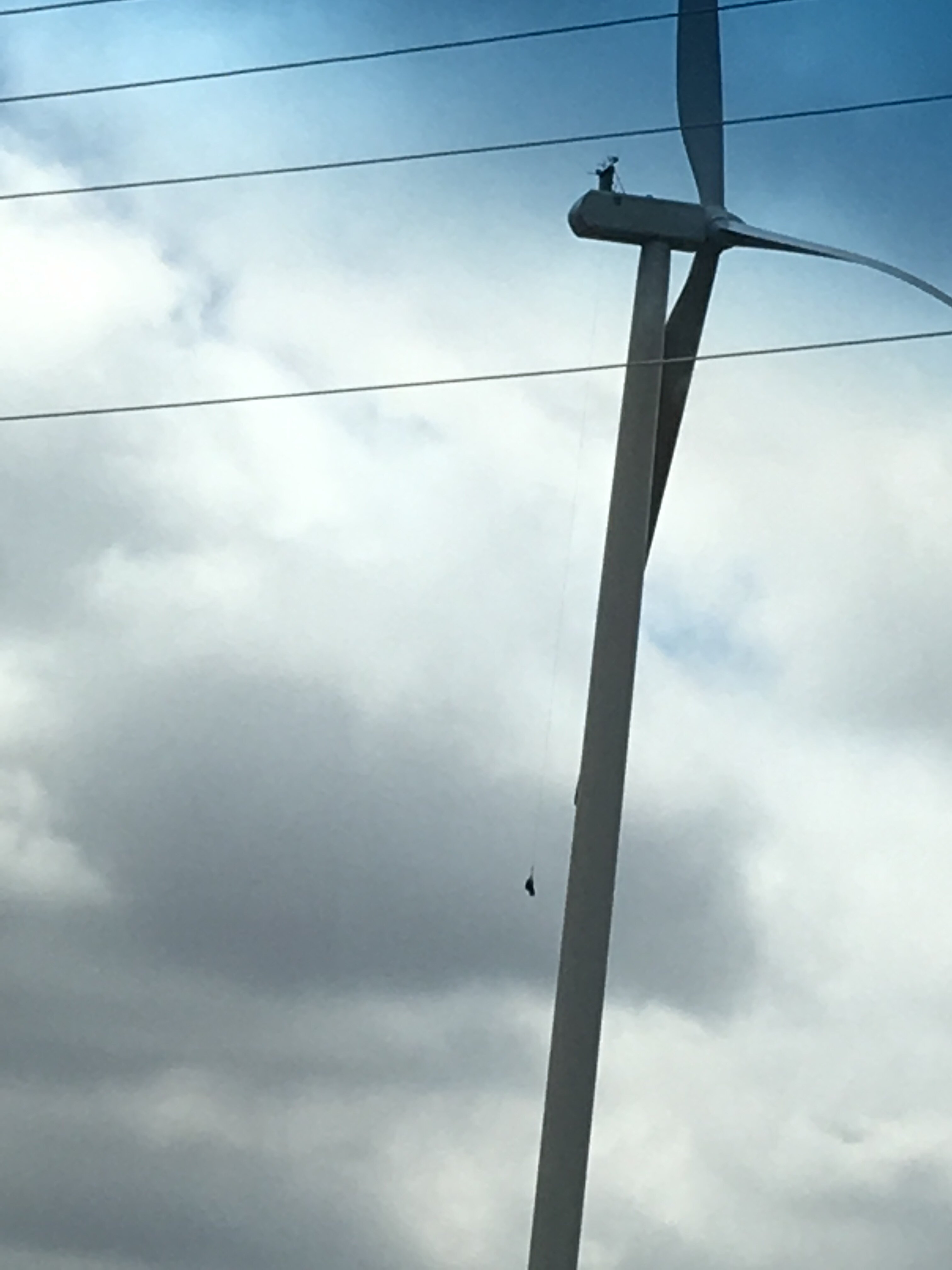

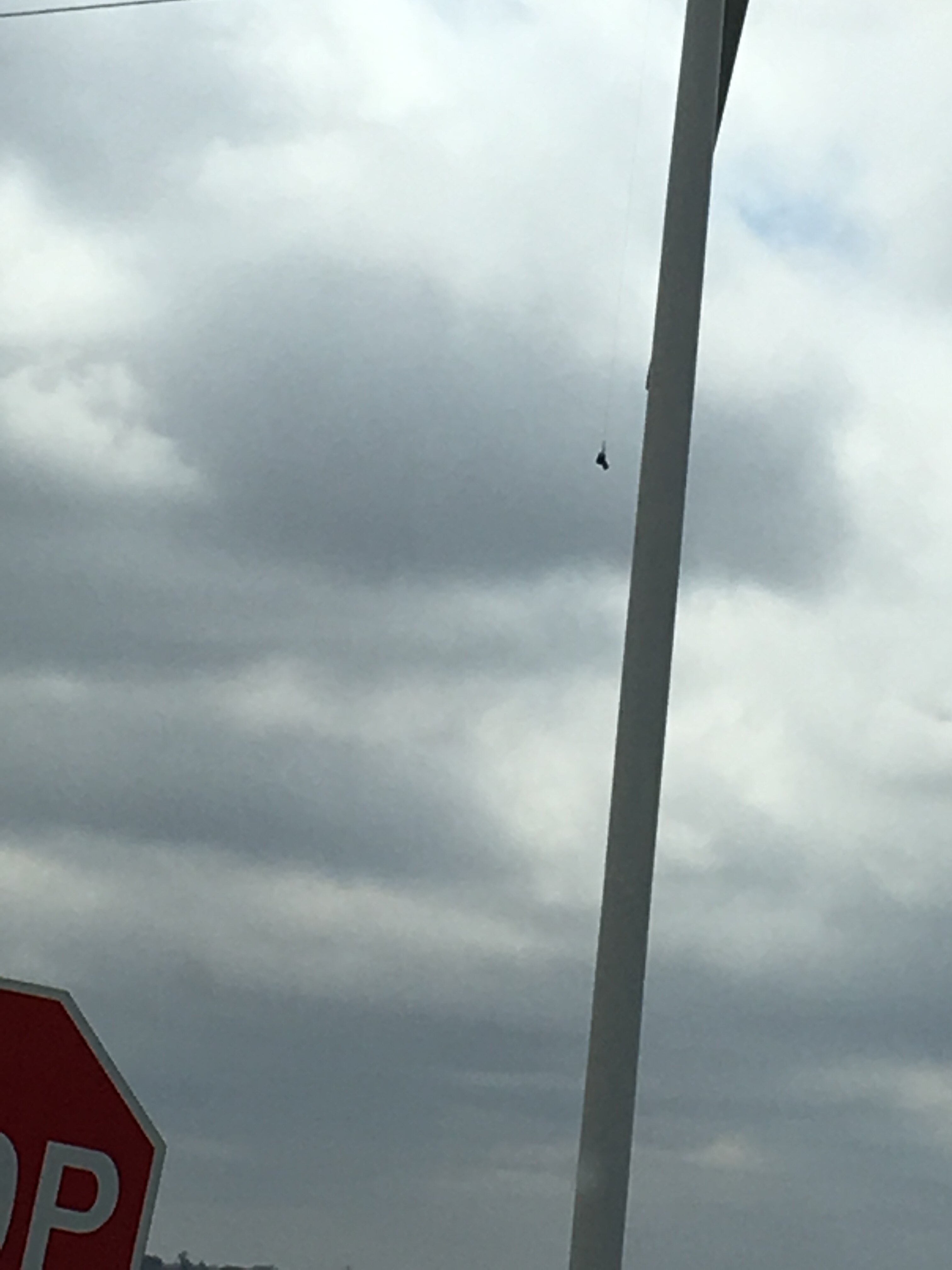

today they had a big thing hanging off the tower. had lots of wires on it. my pictures dont show them like my bosch and lomb does. pictures are taken from about 3/8 mile away
