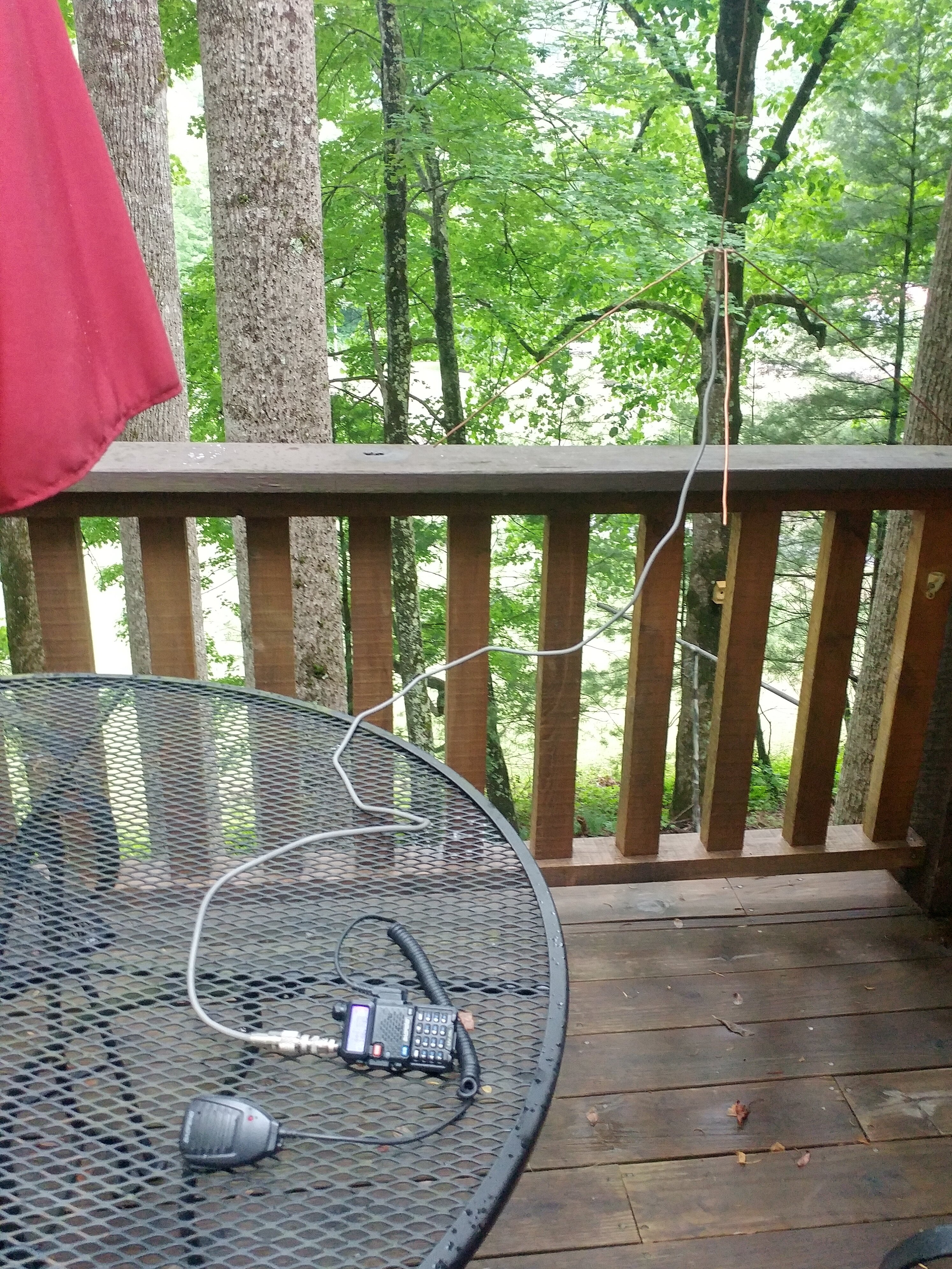

I broke down yesterday and ordered 1 Abbree 28 inch antenna, and also a Signal Stick for my 2 new UV5R'S (8 WATT), or close to it radios. I'm not going to be packing them around in the battle field, just on my back porch and around my property. I'll give them a good test. They both look Ridiculous, but that's ok. Hope they work better than the antenna supplied with these radios.
This is my 2m/440 command post when I'm not in the shack. I'll have to prop the radio up when I use the AR Antenna. Look real close for the homebrew 1/4 wave ground plane antenna. If you zoom in real close you'll see my diy 6m horizontal Dipole. 73
