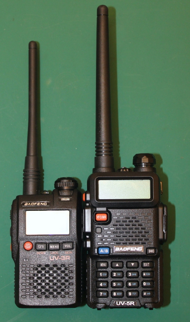

UV-3R and UV-5R Pic
As promised earlier, here is a pic showing the UV-5R next to the UV-3R for size comparison:
