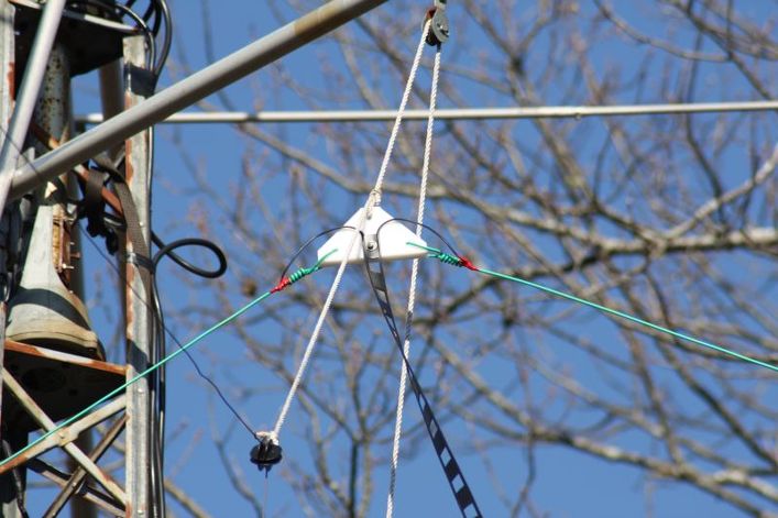

I have to disagree with you on one thing Gary.....that is unless you are part of the 95% of the people that mistakenly call that yellow polypropylene crap nylon. I can't even begin to recall how many people call that poly crap nylon. That stuff deteriorates in the sun and becomes full of little splinters. REAL nylon rope is usually white and silky soft and smooth and almost slippery feeling. I have used in it sunlight for years and except for a slight hardening from being wet/dry so many times it has never deteriorated a bit. One piece was on my parents clothesline elevator for over a dozen years and was still fine. I use it as my main tower rigging ropes and all my hoisting slings etc. are all made from NYLON rope. Come to think of it the white rope in the picture I posted above is nylon and had been up for years as of that pix.
